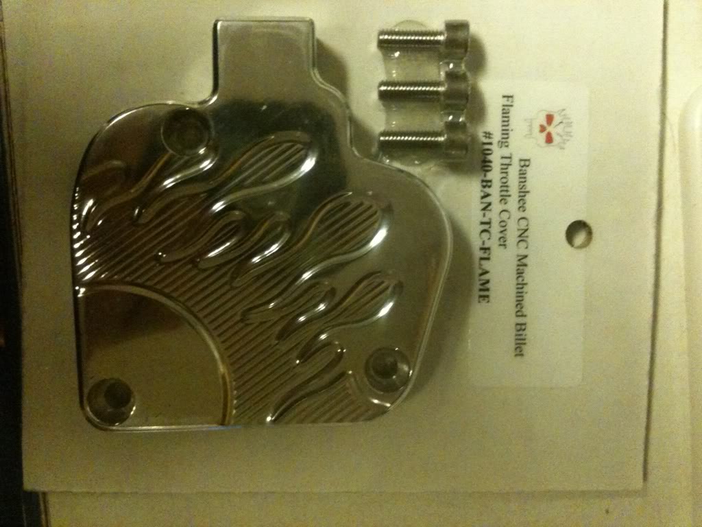

Ithink I found the throttle hang problem. Took the thumb throttle cover off and found one of the old cover screws lying inside.:-[
