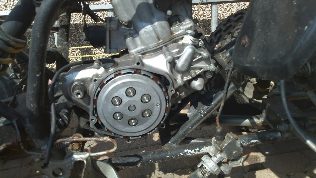

Where the motor sits now before cutting off frame mounts:
The whole thing:
How much room i have to drop the motor after I cut the mounts:

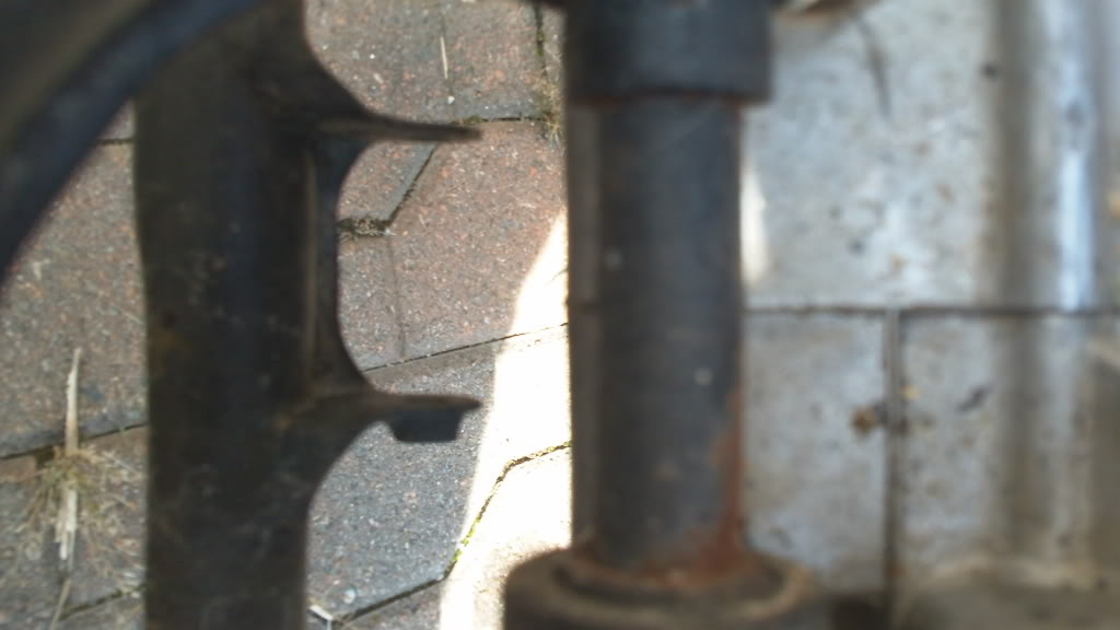

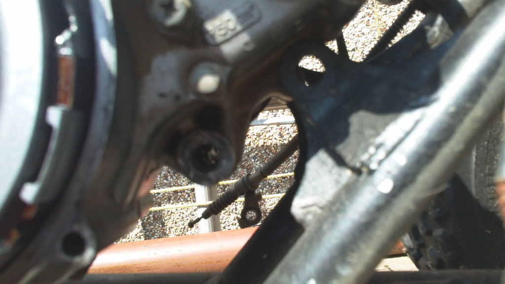

Mount that is in the way:
Swingarm to be cut to fit:
