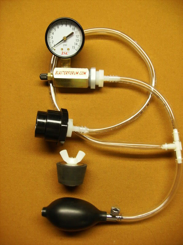

This is an extra tester I made and is not a commercial unit. I made it outta all new stuff so it should serve someone just fine. The bulb will only pump to about 8 psi so it's safe for the gauge and your seals. The intake side fitting should fit stock & PJ34 carbs. Lotsa spigot sizes out there so you might have to mod to fit your boot. There are no guarantees, if it don't work for you then give it to someone who can make it work.

Leakdown test.
It's the only real way to find out where your airleaks might be w/o alot of hit and miss guesswork. First tighten things up to specifications (head bolts/intake bolts/spark plugs) You pump it up to 5~6psi. I remember reading somewhere, that if the leak is more than 2 psi over a 6 minute "sitting" period, you probably got a problem. If so, Take some windex, spray the head/base/intake gaskets & boot and even the tester itself to see if that is leaking (like i did)...if you see bubbles anywhere, that is where your leak is and you need to tighten things/replace/fix up in that area. If you don't see a leak, but it's still leaking 2 psi + over 6 minutes, you probably need to at least pull the points/generator off/ignition rotor and spray the left side crank seal, bubbles? that's a leak...no bubbles, no leak? Then drain the oil pull the right sidecover/clutch basket/primary gear and spray that sucker, i would guess, if the left side checked out okay.. You would probably know if a right side seal was gone (mine was ripped to shreds)...the smell would be like burning plastic and it would run terrible. A leak on the left side would cause a high idle or fluctuating idle and it would be near impossible to tune (jetting, good luck!). (I'd have a slightly high idle and then it would settle down, but i think my problem is in the carb itself (sticky slides or maybe when i tried to run castor oil and then didn't clean the carbs out?), since i can rule out leakdown not causing it).
It beats the hell out of guessing and lets you know exactly where the leak is. A fresh engine rebuild can leak, so many builders do a leakdown to prevent a problem from happening. I.E., they see the bubbles, tighten things up and retest until things are right. If it's a bad crank seal, then the engine can be taken apart (since it's already there on the bench) and better seals put in to fix, instead of having a seized motor return later with most probably an angry customer!!

Leakdown test.
