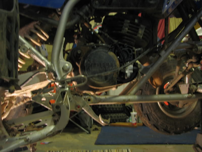

My clutch wasn't working on my 2002 Blaster, so we decieded to tear it apart to see what was wrong. So I decided i'd go ahead and make a DIY on how to take your clutch apart.
1- The very first thing you HAVE to do is drain your tranny oil.
2- Next, you need to remove your kickstarter with a 3/4 socket.

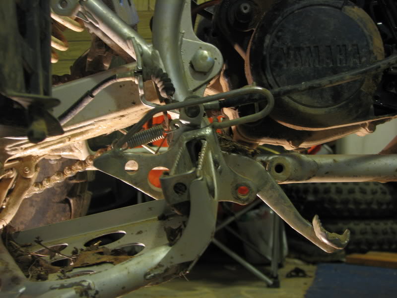

3- Next, let your footpeg hang by taking off one 11mm bolt and two 14mm bolts.
4- Remove spring for footbrake on footpeg.

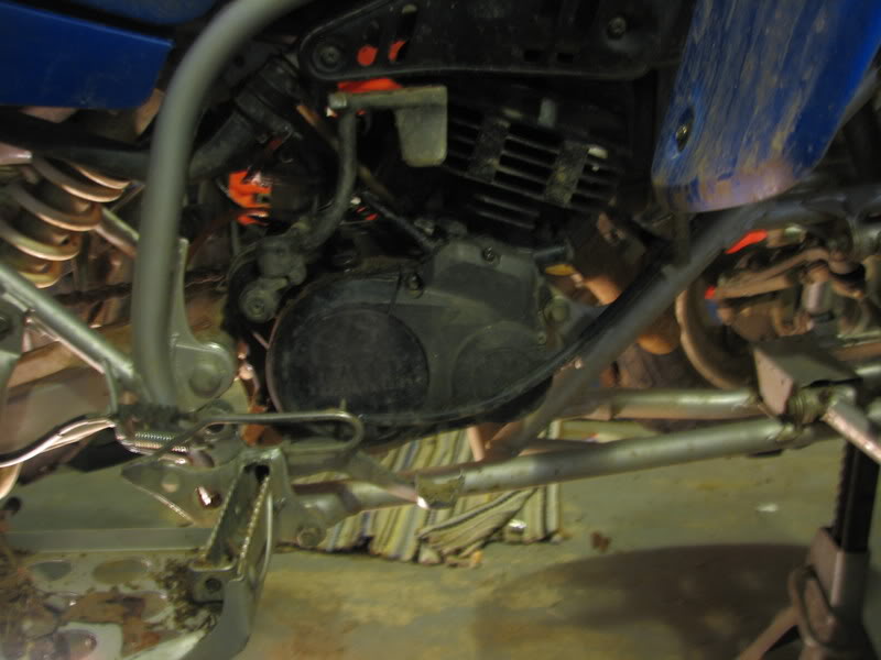

5- Remove Oil Pump cover with 4 phillips head screws.

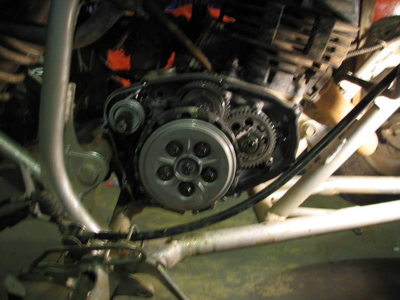

6- Remove Clutch Cover with eight 8mm bolts.

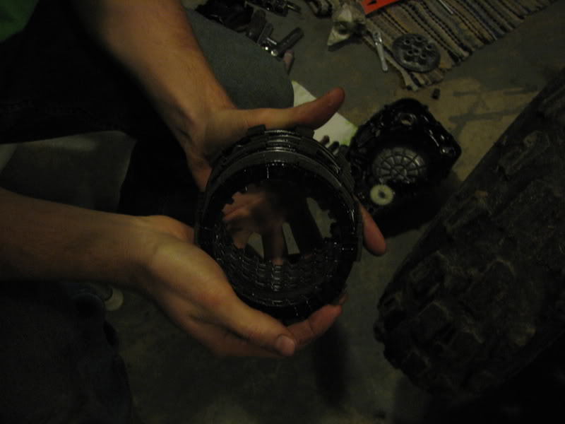

And here is your clutch-
And here is your clutch basket-

there is a rod with a phillips head on it and a nut,,, pictured in the second to the last picture it will be in the center of the pressure plate. screw it in till it stops mabey let it off just a hair and tight the nut.... he did not explain changein a clutch in this section so far........ you will need to soak your fiber clutch disks first and place a fiber first followed by a metal and go back and forth there are notches on the outside of the metal disks and you will place the first one at 12:00 and each following metal goin metal,fiber,metal,feber,etc.... 60 Degrees or about 2 spaces on the basket from the last... there is one fiber that is a smaller diamiter you will place this smaller fiber as the second fiber that you install and if you are using the rubber cushioner "big O-ring" it will be placed inside of that fiber. be sure to tighten the pressure plate to tourqe specs and do it in a criss cross patter. you will tighten them down criss crossing until they just stop and then torque them. hope this has helped any thing else just post you question.

Also, when you take the clutch apart there is a little like BB type of ball behind the rod, dont loose that or forget to put it back in, cause than you have to re drain all the oil, also after you are done adjusting it, make sure you tighten the nut or you will start to ride and then your clutch will loose all its tension. Not a big deal, but dont think you actually have to take the oil motor off, it comes off with the clutch cover, just a few minutes and more parts, but that is your preference.
