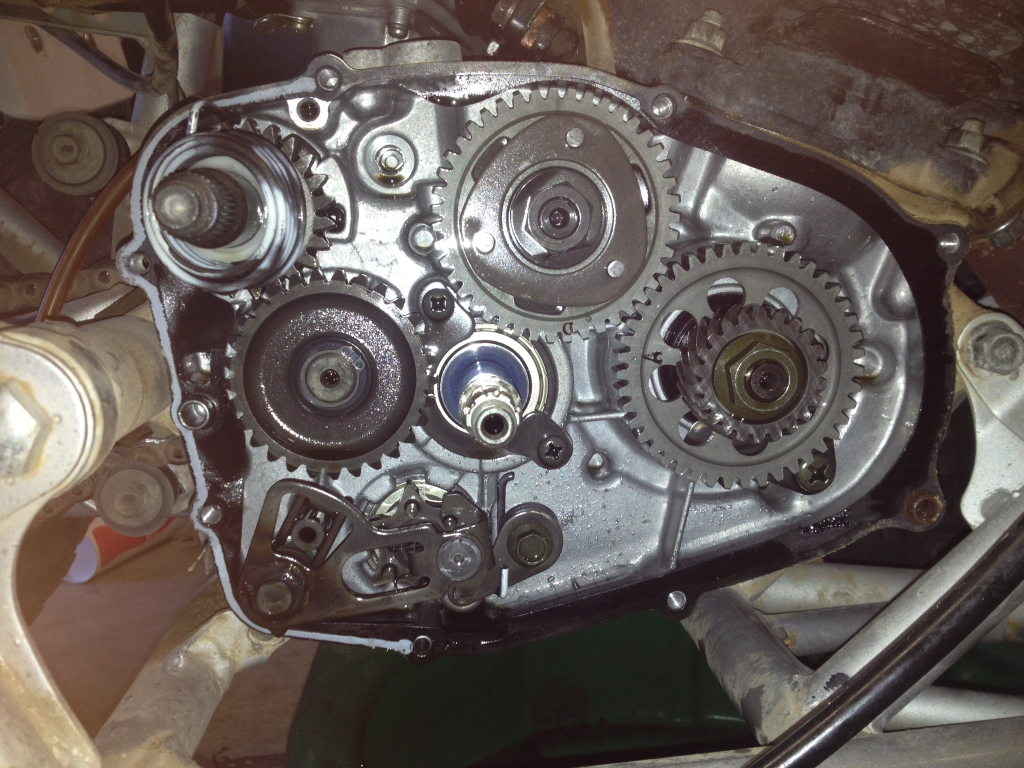

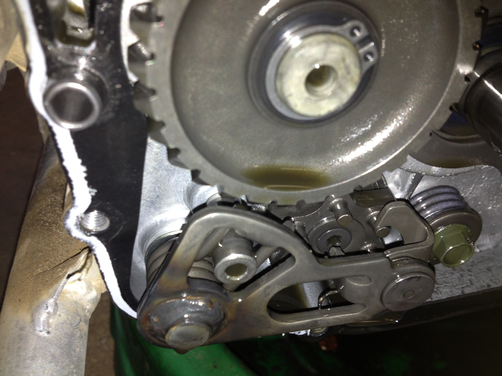

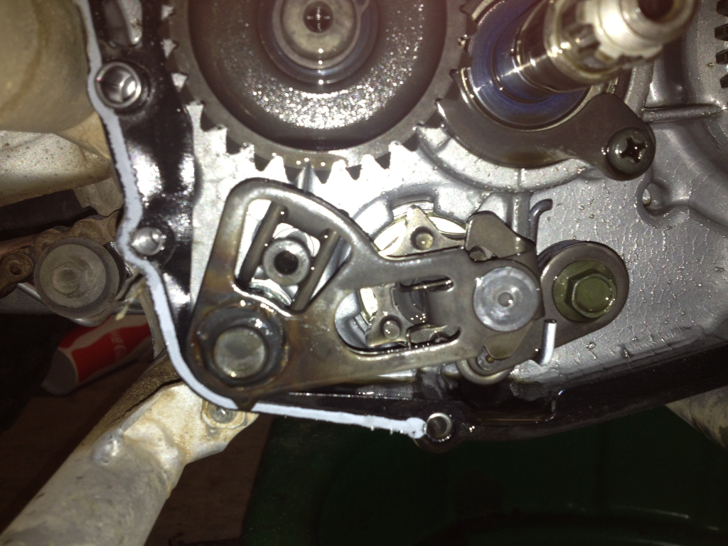

Just now got the clutch apart not to sure what I'm looking at so hopefully this helps the diagnosis and sorry for the giant pictures forgot to resize
Check to make sure the screw for shift star is tight. Then you might want to pull shifter shaft out, after thuroughly cleaning shifter end of it, and try bench shifting it just with end of drum/star. shift shaft might be bent.
Unless you have an eagle eye, use a straight edge, checking about 4 places around it. Bench testing is what I call shifting it thru gears when motor is on "the bench" you have to spin the clutch (main) shaft with your hand while moveing the shifter, but in this case you will have to use a TORX bit on the shift drum/star. If it wouldn't bench test using shifter but does with star/drum, you have a bad shift shaft. We want to eliminate all possibilities before you split the cases .
Ok so it shifted through all gears with no problem with a torx bit I put the shift shaft up against my carpenter square and went around it and I think it is bent its very very slight though
