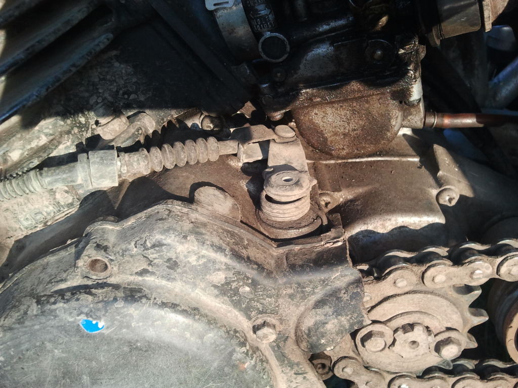

Ive used the udjuster up by the handlebar lever, but that didnt help much, here is a pick of the lever on the case

Slow down there little buddy, just because you're faced with a problem doesn't mean there isn't a solution...we just have to put our collective minds together and help you out. As for your picture of the clutch lever, the mark will be on the inside from that position, go to the other side of the machine and look thru to your lever and you should see a mark.
