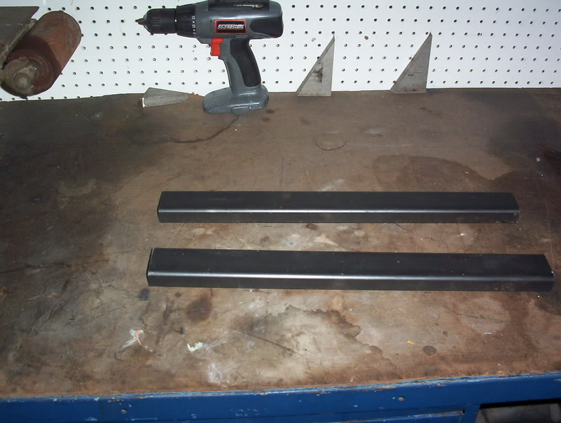

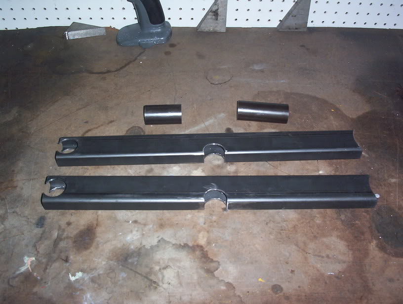

You can't notch with a chop saw...notching requires a round precise cut at the right angle to weld them up and not look so sloppy. We can make yours with a chop saw...LOL
Yeh that's exactly what i was trying to say. if I build one, it's gonna be sturdy and handle jumping and what not...i will test before I produce anything.

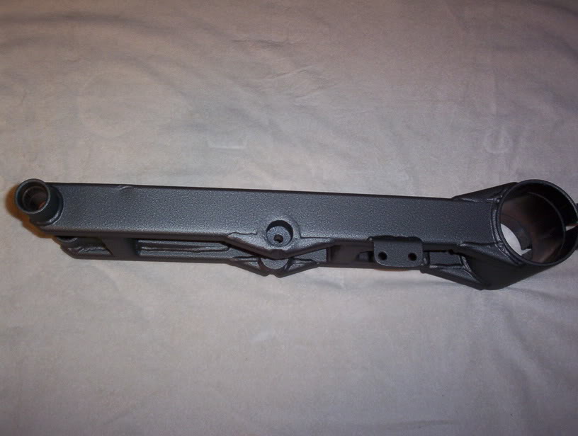

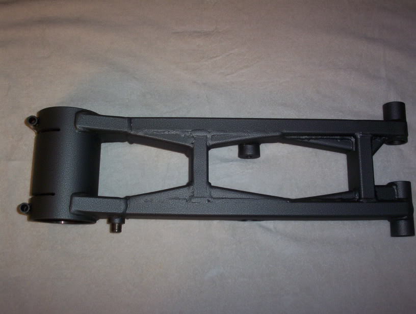

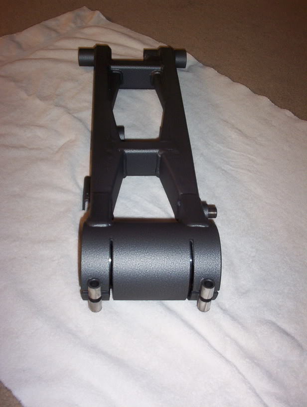

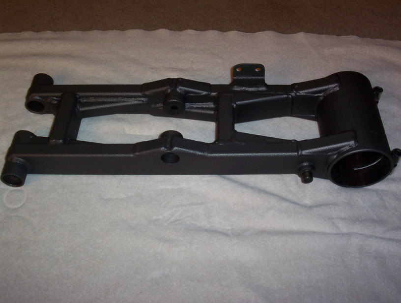

Phragle....that looks like the one I posted a pic of a few days ago?

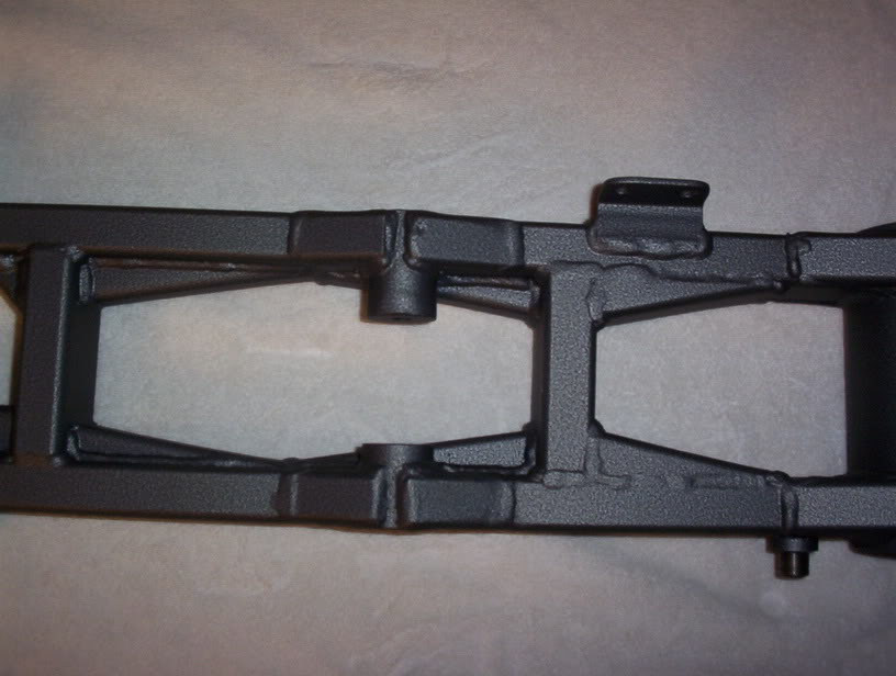

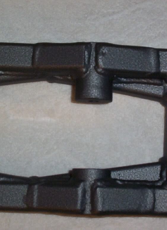

Hot did you fabricate the pin for that shock through the swingarm? Curious as to what you used...and how is it removable? Any advantage as to using the same ol' shock tabs?
Thanks alot Phragle..
Advantage to moving the shock mount?? how about more than doubling the wheel travel. used a grade 8 bolt.
