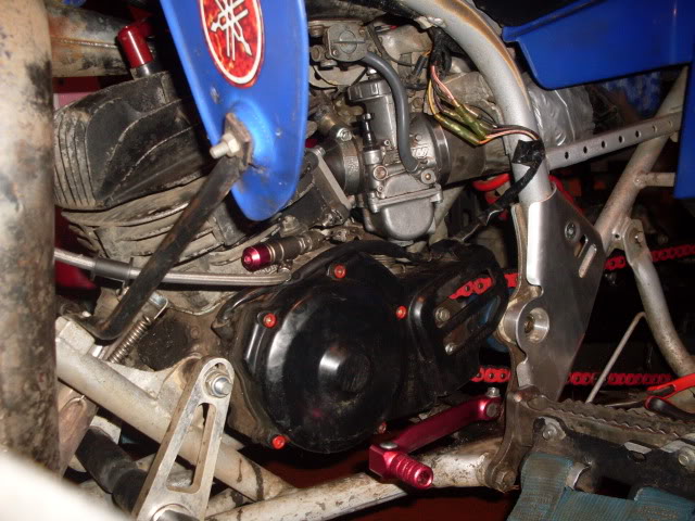

Its cool you gave it a shot , I've done the same thing and sometimes you win , sometimes you lose . yeah some pics of the mods would be nice , so we can see at leat how you ended up mounting it.
Theres really nothing special about mounting it up.

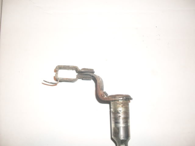

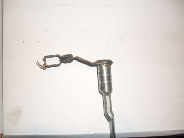

I just bended the mounting plate on the push lever like this...

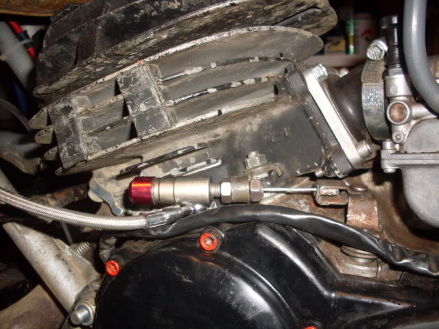

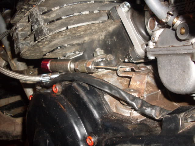

Cut the clutch wire down to size, and weld or clamp a new end tip.
Use original cable mount.
