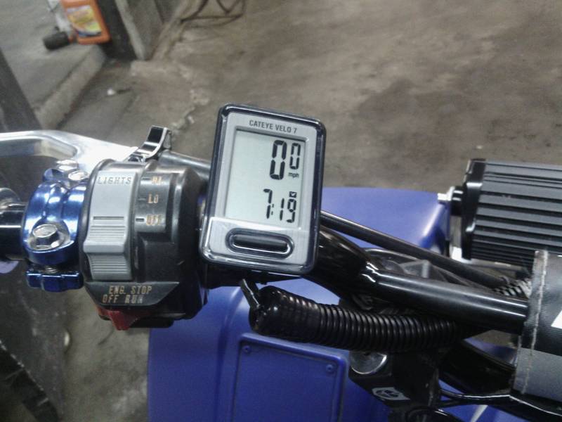

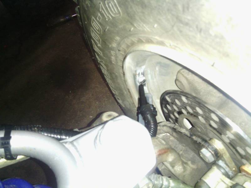

Installed one today on the Blaster for the hell of it . I thought about getting a trailtech vapor but this was way cheaper and does pretty much the same thing . Took a little over an hour to install . Had to make a bracket for the sensor to mount on . It's epoxied and tie-wrapped to the bracket . And epoxied the magnet to the inside of the front wheel . The bracket is mounted to the steering knuckle bolt . Should be pretty cool for keeping track on the ride time...total time and trip mileage and total mileage . It has speed...average speed and top speed also .
