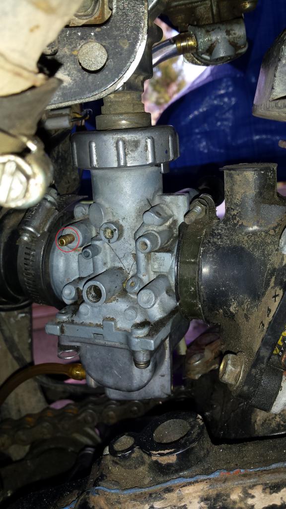

This is the other side of the carb speedyslyder...if you notice anything else wrong with that side that would be cool to let me know so I can fix it

The nipple in the red circle should have a tube running to the oil pump. If the oil pump is deleted and you premix your gas this needs to be capped. very bad to run motor with this open.
that alone will make setting your idle almost impossible.
Alright so I need to cap that...should I use a certain thing to cap it or will anything work really
Yes I do premix 32:1 and I would suppose I could buy caps there...I got to advanced auto parts right down the street or I can go to auto zone which is nearby also
OK...at Least from a starting the ATV standpoint am I in the right area to get it running...my buddies dad is coming over to take a look later today and I don't want him looking at something that isn't even the problem...?
