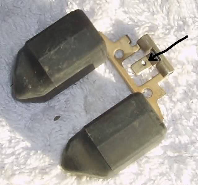

Make sure the tang is not like this.
The indent can weiner the needle sideways causing it not to cut the fuel off.

Re-cap.
No dirt in system,, varnish removed, float not leaking, no ridges on posts, tang smooth, O ring in good condition, float level correct, float not fouling the bowl.
Is the spring on the plunger of the needle working ok.
If everything is assembled correctly that only leaves the rubber tip of the needle, which could be hardened and/or deformed.
