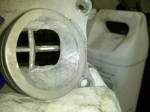

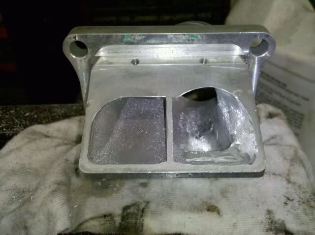

well i started porting the rad valve today. i got one side done it just needs touched up ill post some pics so you can see how much i took off.

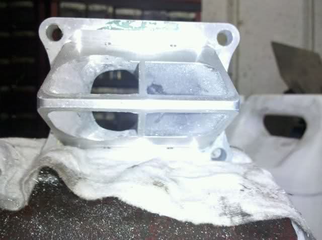

i still have the sides of the intake to port out and the sides of the cage to take in but here is how she stands right now
I hope to port the other side and clean them all up tomorrow. Then I'm gonna smooth and Polish the inside for better flow through it. I'm also gonna Polish the whole cage shouldn't take long
Looks good. I thought about doing the same thing to the new blaster Rad valve i got.
But I want to run it before I do any work to it then I have something to compare other than the vforce2 I had.
