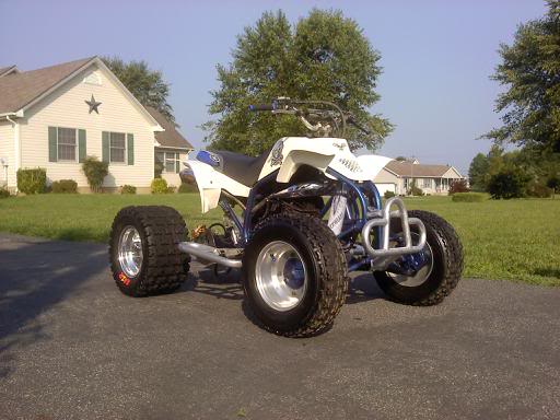

Yes, they were stock 1989 blaster fenders . I didn't cut the fronts but I did cut the rears. The plastics were really screwed up and I sort of like the raptor style fenders so I got my 4 inch angle grinder with a metal cutoff disc and hacked away with the fenders bolted on .

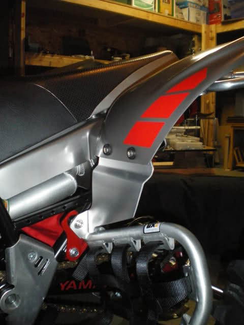

Yea, thx if those comments were aimed towards mine. I call em fender guards and they make both sides match while replacing the factory mounts and stiffening the fender while adding protection where your boots hit. They were made out of .190 aluminium and the fender must be trimmed down the side the bottoms. Anyway I have an old set of fenders and was planning on making a mock up set for those, not the custom maiers pictured, but haven't got around to it yet. If there was some interest showed I could possibly make a couple sets.
