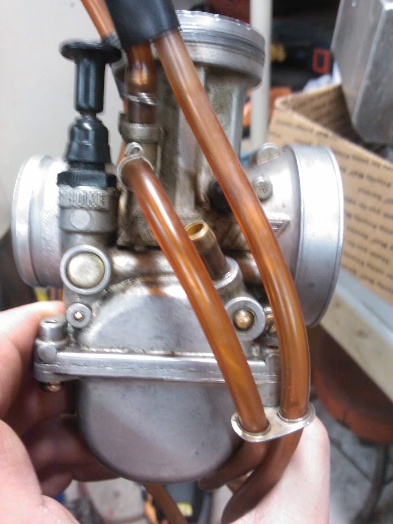

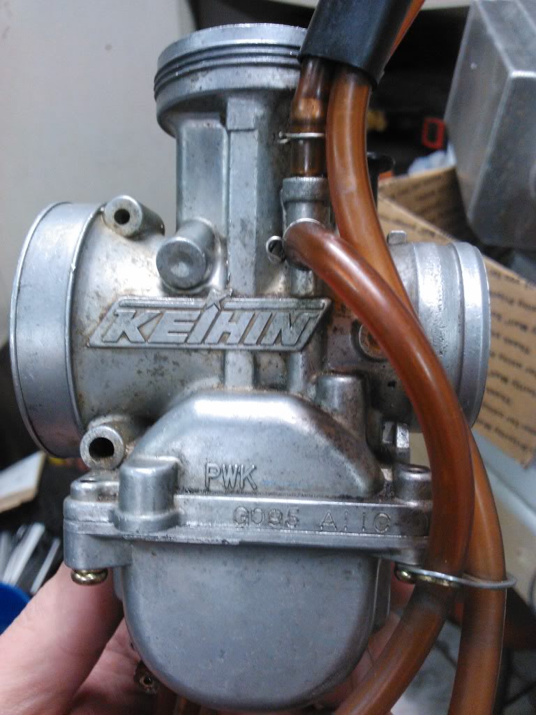

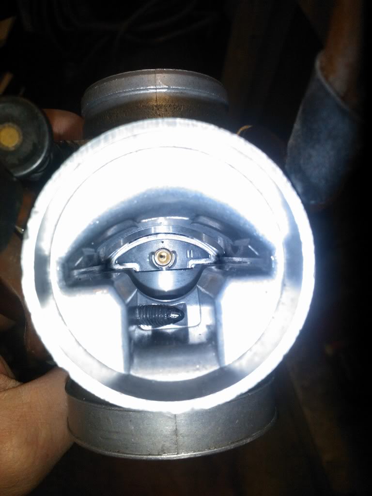

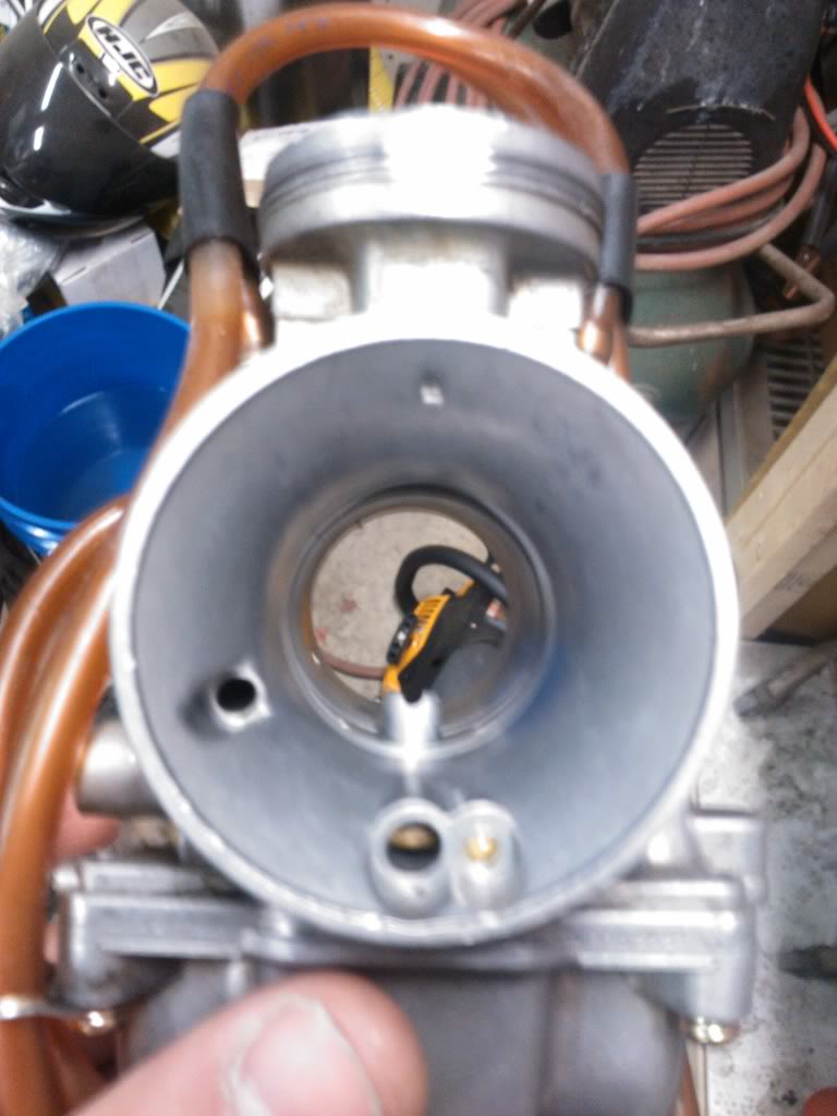

As some of you know this carb has been kicking the living chit out of me. I spoke to the guys at carb parts warehouse and when I described the carb they told me it was a 36mm pwk because it is a quad vent non air striker. I ordered a slide from them and it didn't fit. (to big) So I broke out the calipers and measured it. Filter side measures 59mm outside to outside. Intake side measures 42mm outside to outside. Those are the exact measurement of a 35mm pwk. Now is where I'm confused. Supposedly there is no such thing as 35mm, quad vent, non air striker. I will be calling carb parts warehouse again tomorrow and emailing them pictures. Just figured somebody might want to earn some green.
Here are some pics
Here are some pics
