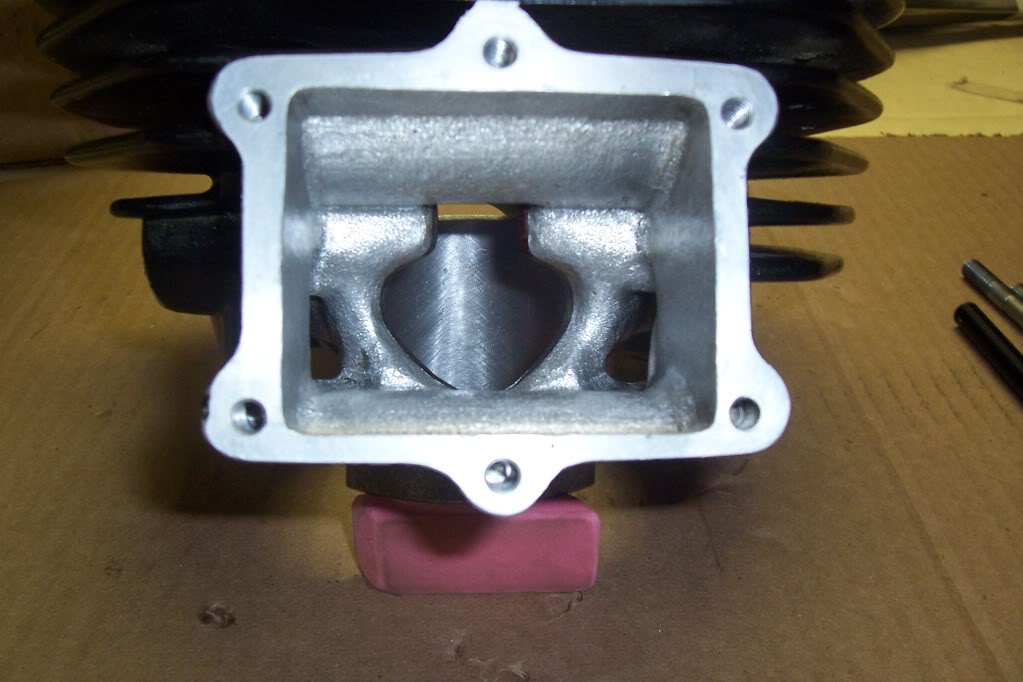

ONLY the 200cc has the aluminum sleeve and Nikasil plating!!!!! The Sonic cylinder kits are available in two basic packages: 200cc to meet AMA youth race rules and the unrivaled 240cc big bore package. The 200cc cylinder utilizes and aluminum sleeve and Nikasil plating to offer maximum cooling under race conditions. LOOK>>>>BLASTER
CT240

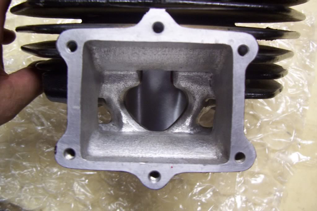

Pics speak louder than words!
CT needs to hire better help then. I emailed LA, Vitos, and CT to get info on their cylinders so I could decide which one I would go with. Like I said, I was basing my opinions off of what they told me. And typically, unless I see for myself(which I can see now), Im always going to believe the manufacturer over people on a forum. So now I gotta see who will sell me just thy cylinder at the cheapest price :D

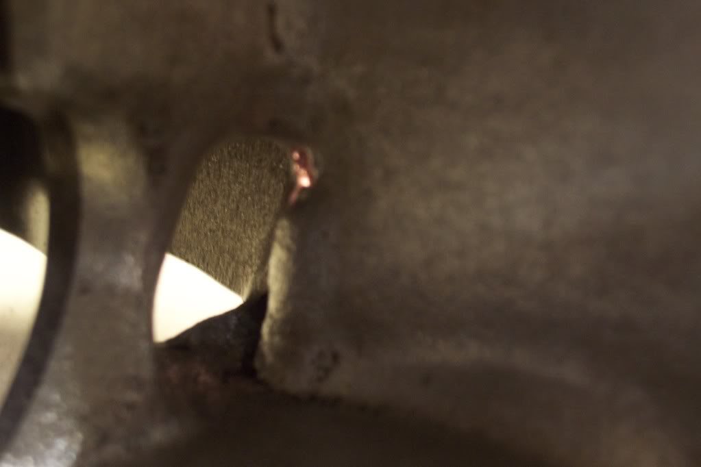

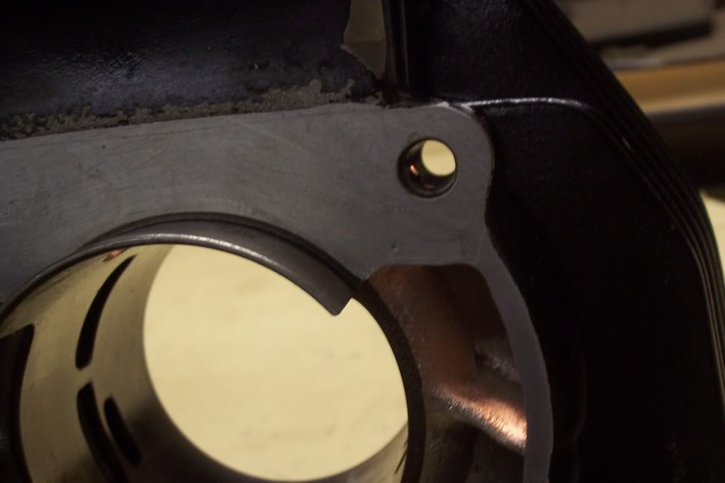

No problem bro, and nice shocks... You may also want to ask if you can get a virgin cylinder.... The cylinder i got from CT was a standard out of the box trail port, and look at the hole that developed in the port... that hole was not there when i put it together, but after 4 years later it was time for a piston and look what i found... So if i was to do it again i would get a virgin and send it to OConnor Racing to have fun with..lol
This hole is a possible problem with both the CT and LA 240 BB cylinder because of the bigger reed cage and ports, and is NOT a problem with vito's or the stock cylinder....
