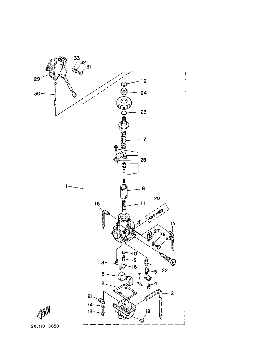

Cam defran Member Apr 13, 2019 50 9 50 36 Green Lane pa Sep 30, 2019 #1 Anyone have any advice on how to fix this problem? Also how do I post pictures? Does it not work from a cell?

Awk08 Administrator Staff member Technician Jan 30, 2009 24,427 2,292 175 Sep 30, 2019 #2 Posting pics......... https://www.blasterforum.com/threads/how-to-post-pics-on-this-new-forum-layout.57951/ https://www.blasterforum.com/threads/resizing-pics-for-uploading.58385/ Bogging in whoops..... Float height correct ? Vent hoses open to free air ? Slosh baffle around the main jet in the float bowl ? #16 on the diagram
