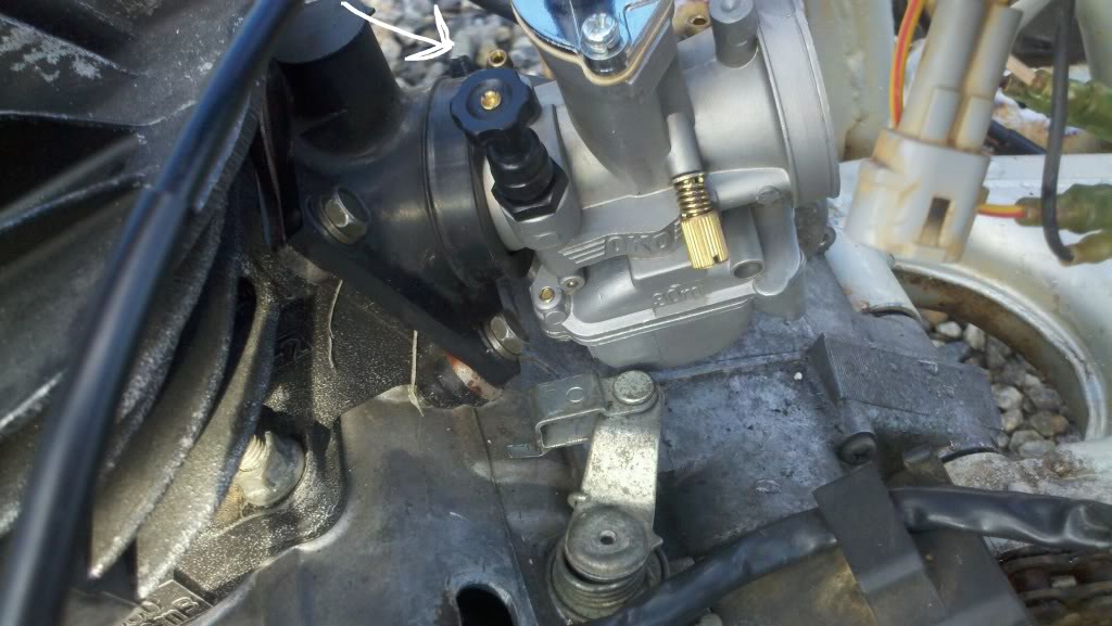

ok guys, so my OKO carb came with an oil injector nipple on the back side of the carb, adn im looking for idea on how to block this off.
one solution i came up with was geting the nipple to break off adn then using jb weld over the hole.
what do you guys tink about this?
What ive currently done is took some old hose, adn then screwed a big large screw into the link on one end making a cap for it, but this looks like ass.
I cant find any of the vacume caps that will fit it locally for somereason. they are all like 1/2 inch, and this thing is 1/4 inch or smaller.
you may have to get an assortment at the parts store
and my 30mm oko didn't have an injection nipple on it.
hmmmmm "nipple" on carb
unless OKO carbs are diffrent i dont think i have seen an oil injection on a carb...........maybe im just not getting what your saying
yeah, i'd like to see proof of this also, and copied directions that say thats what it is and for.
and an auto parts store should have a cap
well then, thats very peciulair, but definately looks like an oil injextion to me
any auto parts store should have a "vacuum cap" to fit that
maybe autozone was just out of them. or they have them in the back with the hoses. does that look like a 1/4 to you guys?
possibly the metric equivalent of 1/4"
and like stated above, i've seen them blockoff caps in an assortment pack
did you ask them at the auto store
dont get us wrong, the tubing with a screw siliconed in will work, thats how my sons stock oil injector is blocked off, with a piece of heat shrink tubing over that for added security
but the vacuum caps are a better choice
man this has came up before... noone remebers the last time someone had one of these?? for some reason i want to say that its not oil injection even though it looks that way but its something else, i cannot remember what (damn scooby snacks lol) but regardless just block it off.
