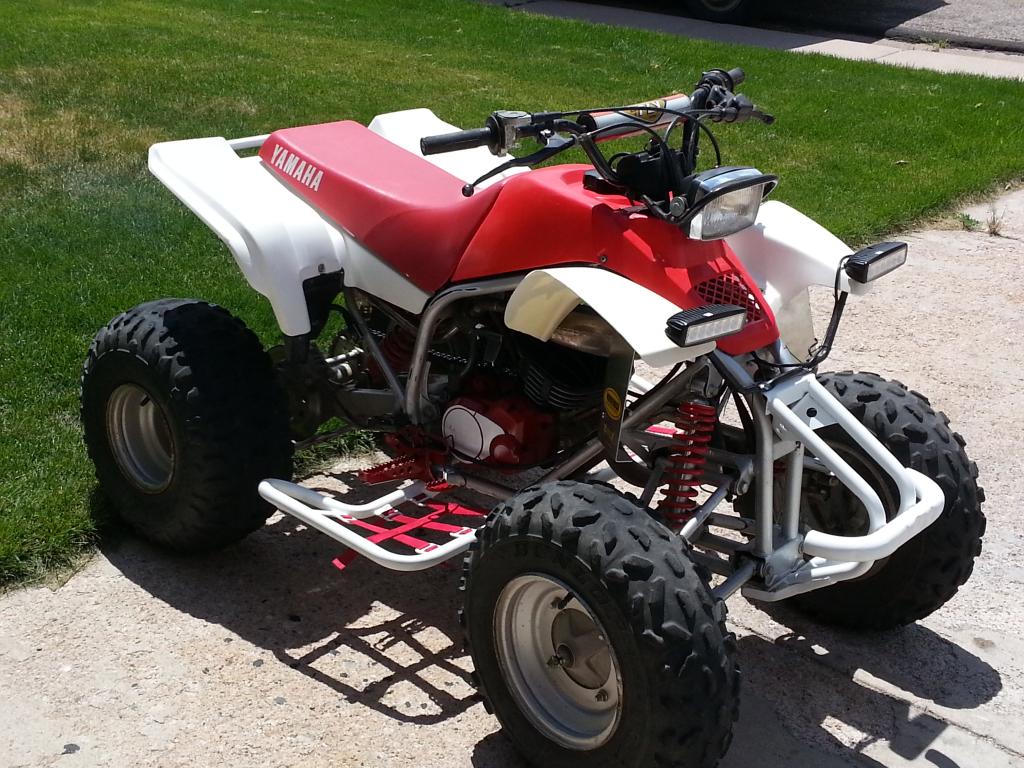

I went with fender mount. More traditional. I put them above rhe fenders for now. I shave them because of a huge crack.
I am going to revisit this when I get new fenders.

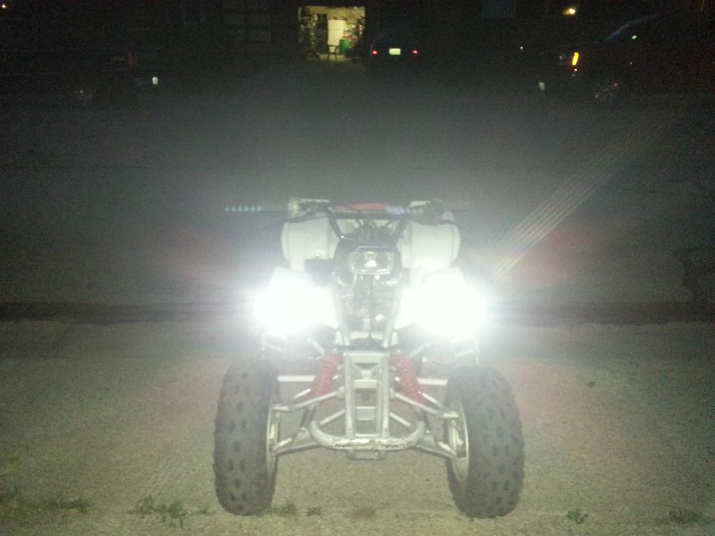

Holy crap they are bright. Really happy so far. I didnt get my rectifier uet they are just running off the lighting coil for now.
They flicker at idle, kinda drive me crazy.
I got comparison pics. Had my flash on. DOH!! Will get better pics tonight.

Well the blasterpiece is gone! Kinda sad about it but i got a hell of a deal. Ended up making a couple hundred bucks. Traded it for a 2000 Polaris Trail Boss 325. This thing runs good looks great and is severely underpowered. PERFECT! Jon is going to be so happy. I need to do some maintenance, Change Oil, Adjust Brakes, Clean and Tune Carb. Stay tuned this winter for the next Blaster Build.
