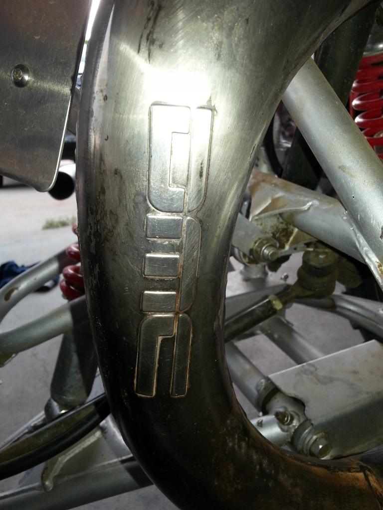

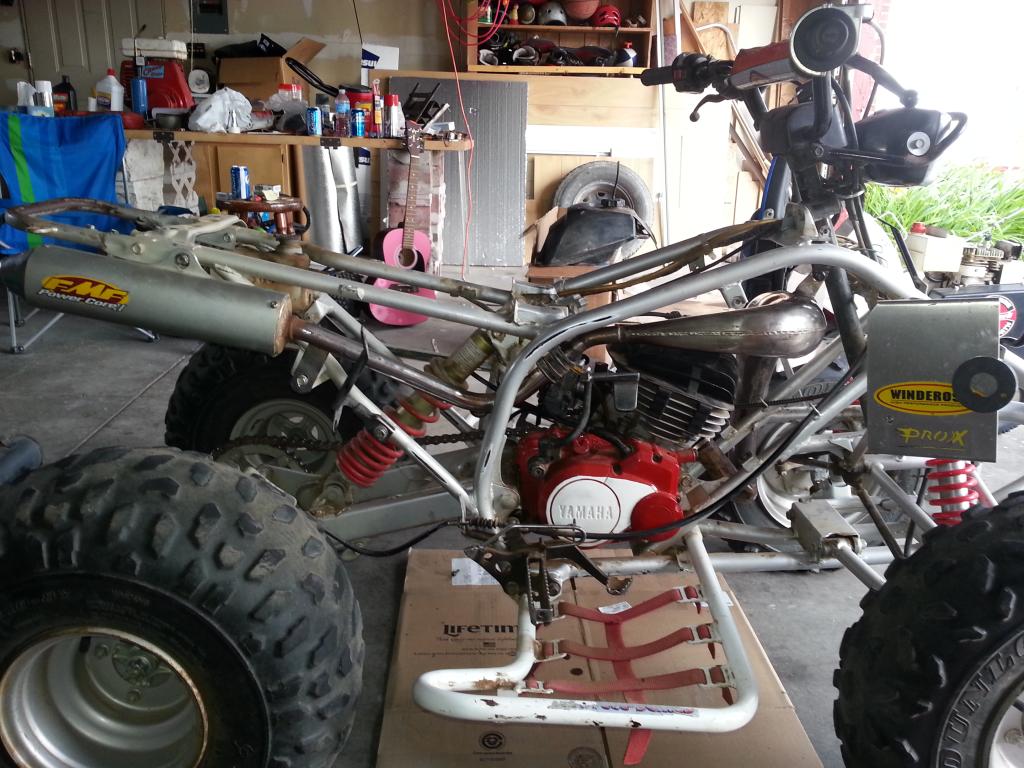

I got My DMC/FMF exhaust from Dirtysquared on Saturday. Him and Heck and Blaaster cleaned them up for me. Not necessary but appreciated. They look amazing. Thanks again guys. Really excited to get it on and start playing with it. I also got my Flood Lights. I did start fabbing up mounts for them. I will get pics up tonight of my progress.

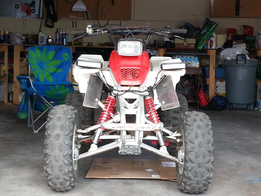

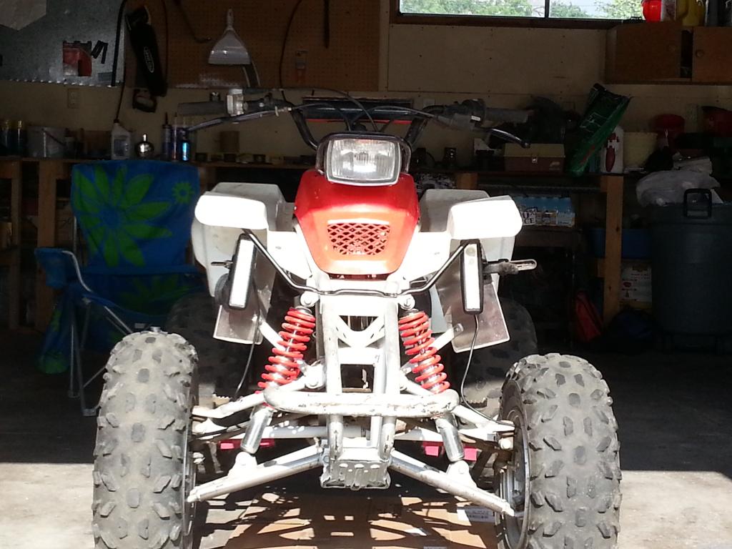

I have the lighs narrowed down to two mount configurations.
I need help deciding.
Option 1: fender mount. Traditional. Leaves room for custom plastic/fireglass work in the futue.
Option 2: vertical scoop mounts. Non traditional. Looks badass. Potentially restricts airflow.
