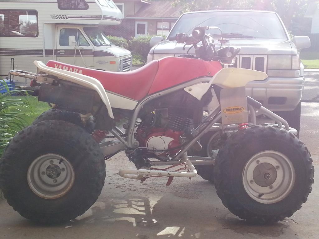

I put yfz 450 heel guards on mine. Little different. Pegs mount perfect but you will need a bracket for other mount. I was able to heat mine an manipulate them into place.
Those are really nice. It would be rockin to trim the fenders to follow that profile. Thanks for the ideas.
These will stick out past the tires with stock axle. Once I out the banshee axle in they didn't.
With the stock axle they will stick out past the tires. With a banshee they won't, as seen in the pic.

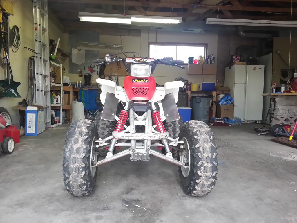

Here are some pics of her after i Shaved the fender and installed my CFM Scoops.
I really like the first pic. I wish I would have been standing outside as the Garage door came up I had "Also Sprach Zarathustra, by Richard Strauss" going through my head. wish I had Video. It was hilarious to me.

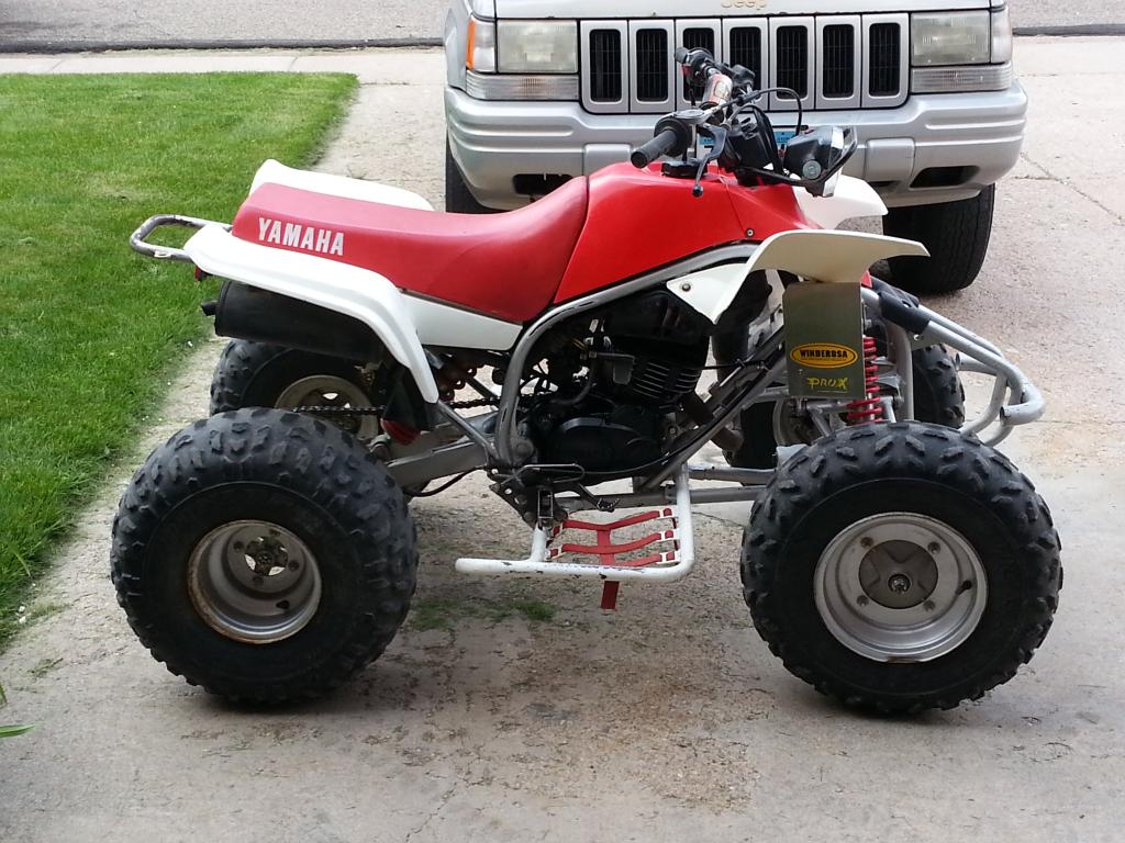

So I decided I needed to dress her up a bit on the cheap. Bought some Engine Paint and went to town. I think it turned out nice. I am definitely going to keep her Red and White. Wasn't sure I liked it at first but it has totally grown on me.
