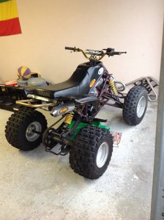

So I found a guy selling a 2001 blaster for $300. He said the kick start is stuck (from what I've read will have to re-do the top end) and it is leaking oil. Do y'all think it would be worth getting?
Might be, depends on condition. These are money pits on a good day, the mod bug is everywhere. Hiding, waiting, ready to pounce when you least expect it.
See my other post for inspection suggestions.
Owner might pull pipe or head for a peak. Piston, bore, gaskets will be about $200.
Or it could simple as a kicker or clutch basket problem.
$300 is the "range" I'm looking for for a "flipper" Fix what's needed, sell little lower than going price CL to move it. Make a few bux, move on to the next.
The BUG has grabed me by the ballz.
What started as a broken case from balancer gear/bearing failure is getting out of control. Rod is getting loose, so might as well get new crank while it's apart. A 3mil isn't that much more. Top end has relatively low hours so it will be basically a new motor. So I might as well make it look new. Going to blast the cases and coat with either clear laquer or enamel, jug/head will get special black paint.
If it is leaking oil the cases may be damaged from the top end failure. So the simple top end job may involve changing or repairing cases and all new bottom end bearings.
Still may be a good deal, if you don't mind the additional work. Inspect the cases when you look at it.
That one looks like somebody did quite a bit of work on it, could be good or bad. No matter what if its leaking oil you need to pull the top end and split the cases. Once you've done that you may as well get all new bearings and seals before you put it back together, and prob a new crank or rebuild yours. With a top end rebuild, if you have a shop do all this for you, you'll prob have a close to a grand in it before your riding, counting the original $300. That's not bad since you'll know exactly what you got!
Hell you could part that out and double your money. For $300 I would go look at it and see. Could be a simple fix or engine could be blown.
Engine might be crap, but it's sure is pretty. But like tbrooks said you could have it repaired and you would still be ahead. It's worth it sure.
