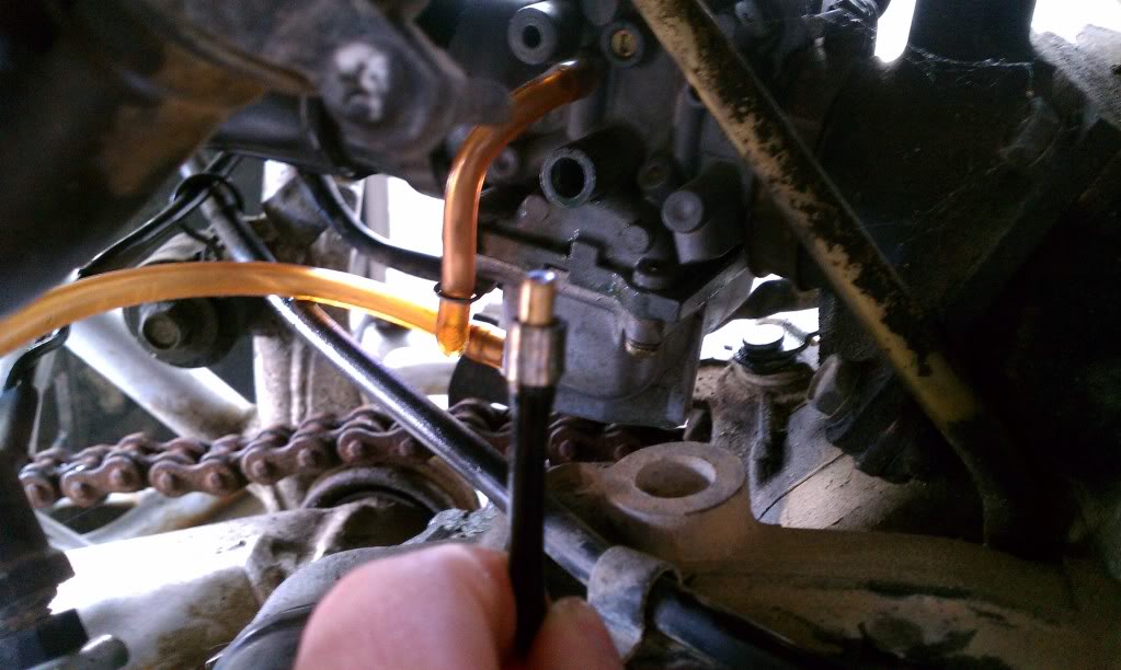

yea, the brakes were stuck lol. Only issues I am having with it now is the idling and running right issue. There is an oil line that goes into the carb. it is really loose and is leaking oil. It feels like it has threads like a nut shoulld be screwed in there to keep it tight. any idea?

It is very important that that oil fitting be leakproof, it controls lubrication.
Slip the brass collar off with a scredriver and pull and wiggle the pipe until it comes off.
Cut about a 1/4" off the pipe and put back on and slip the brass fitting back on.

I am toying with it right now and when I look at pictures of other carbs for sale, there is no fitting in that hole. My injector line has nothing to keep it in there. Is there supposed to be a threaded fitting? Or could someone post a picture of how it is supposed to look because I am confused.
EDIT: Here I took some pictures of the hole and the Line that is supposed to go in there. Tell me what you guys think....
thats a picture of the line and the hole
This is one of the hole i am referring to.
Looks like the fitting has fallen out of the hole.
The hole that it goes into is the uppermost, above the vent hose, beside the little screwdriver slot, top left of the carb, not the one in the middle.
It should be a tight press fit.
