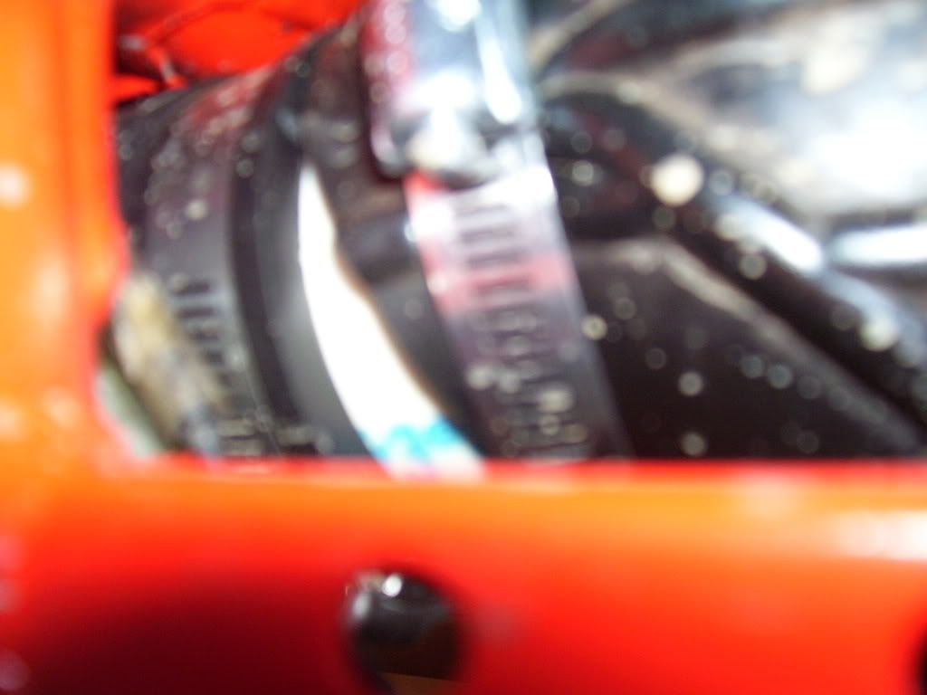

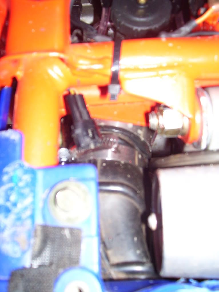

well the OD of my carb is 2" so i went to the hardware store and got some 2" OD PVC pipe and a 2" rubber sewer coupling...
I took my carb boot and cut it back so that the PVC pipe fits snugly into it clamped it down with a hose clamp...
you will need to try to install it, bend the PVC pipe a little then try again until it is bent to the same angle as the carb and then you need to take the coupling slide it onto the PVC pipe and then slide it over the carb and tighten it down with 2 hose clamps
http://i259.photobucket.com/albums/hh313/tjsdaname27/100_1098.jpg
http://i259.photobucket.com/albums/hh313/tjsdaname27/100_1096.jpg
those are the best pics i can get... and I hope i explained it good enough for you to understand..
if you want me to explain it better then just ask...

lol, you did it props to you man, i didn 't think it could be done!I:II:I
dude your the man thanx a bunch thats kind of what i was going to do but now u shoed it to me how long is the pvc and the coupler that u used and how much of the stock boot did u cut so i have a better idea
well, i just cut the stock boot back until the ID was 2"... I dont know how far
and im not sure how long the PVC pipe is... you will have the PVC in your hand... so just cut it how long you need it..
and the coupler was 5" long
and in total i used 5 hose clamps
yeah it is actually more secure than the stock setup lol
heres the trick, go to the local muffler shop, they will have a piece of 2" muffler tubing, take your carb and they can neck it down or up to be a perfect match. then just cut the airboot back as mentioned, silicon the hell out of it and clamp it together. a 250r airbox can be made to fit and work very easily., just try and avoid the 86 if possible, because that had an intake resonator. the muffler tubing will fit better and without that big pvc lip will flow better. when looking at the aftermarket airboxs, stay away from the ones with the narrow necks and and sharp chop saw curves. the best ones will taper and have smooth radiuses
