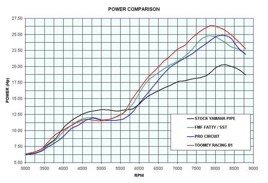

The toomey is very similar in power compared to the fatty only more on top. To keep driving in the nail of your buddies coffin lol here is a Dyno power graph on stock set up's each. which your's is anyway.
Dude a set of toomey's with a pair of Boyesen Pro series reeds and you'll get goose bumps at the kick ass sound and power your gonna get. Check out the thread below and see which you like the FMF or the toomey.

But If I know 1 thing Toomeys a nororious for great power a muscle car like sound and being out of stock a lot so if you want 1 I'd grab it up I:I
Ya I would have to agree and say the FMF fatty would be the best choice for low/mid range power and a reasonable price. I just ordered mine & should be receiving it tomorrow
