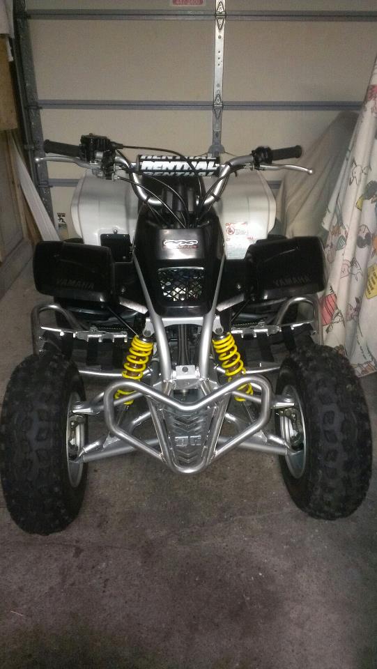

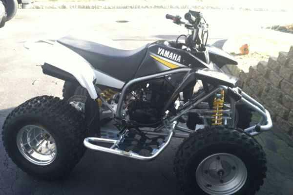

heres a pic of the newly aquired blaster. shes very clean, never really been riding, in my honest opinion its like it just rolled/wheeled out the show room floor. Came with the regi from the dealership when it was bought new in 2002.

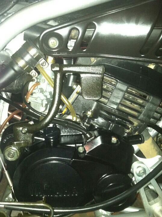

Came home, swapped in a new spark plug, put some techtron in the fuel for the hell of it, drained out the old two stroke oil and replaces it with some new stuff. Adjusted the front brake (took the slack out etc) and shes stoping so much better.
Shes running great now, ripped her around the block a few times, man how ive missed riding a atv. So happy that i chose to get back into riding, along with picking a blaster.
Next thing to deal with is real siezed brake. Ill take it apart, clean it up and grease it up for the time being until i decide to upgrade it.
Gonna go riding this sunday if my helmet comes in before the weekend.
Now that shes running good its time to start collecting some parts for the build. still not sure on the pipe. any recommendations for a ported 240 motor ? from the few posts ive read the toomey is to small or whatever, alot of people are recommending CT pipe, Powerpros pipe/Trinity pipe as they are suppose to be the same exact pipes.
stratton.
Dunno how you drained out the oil but did you bleed the system of air bubbles?
i popped the line off the oil resovoir.
no i didnt bleed out the line, didnt really think much air would get in that little line.
i started it up and let it idle for a good ten minutes before i rode it. rode it for about 10 mins if that total around the neighborhood, it was running great.
didnt think it would be much of a issue. but do tell about bleeding the air out of the system ?
