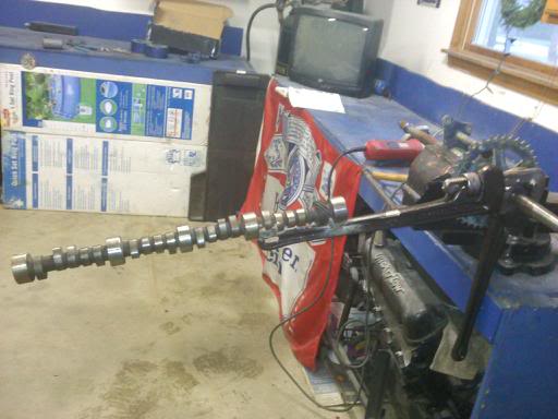

I needed some leverage so I welded an old cam to my pipe wrench. Still was a mother ##### to get off !
hahahahahhahaha!!! That's one way to do it! I just stick a four foot pvc pipe onto the end on a harbor freight bigass monkey wrench. Then bounce on it I:I
yeah then just jump on the bi@%# !!.. like a super tight lug nut. im suprised heat didnt work though.. when in doubt use a bigger wrench , or make one in this case. :)
