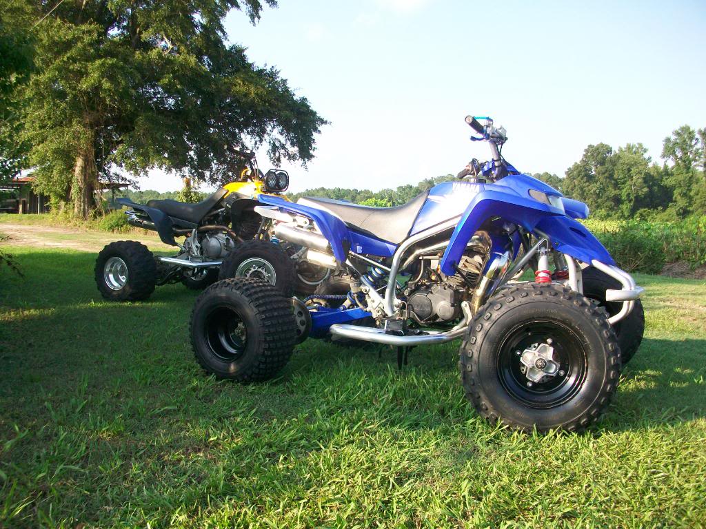

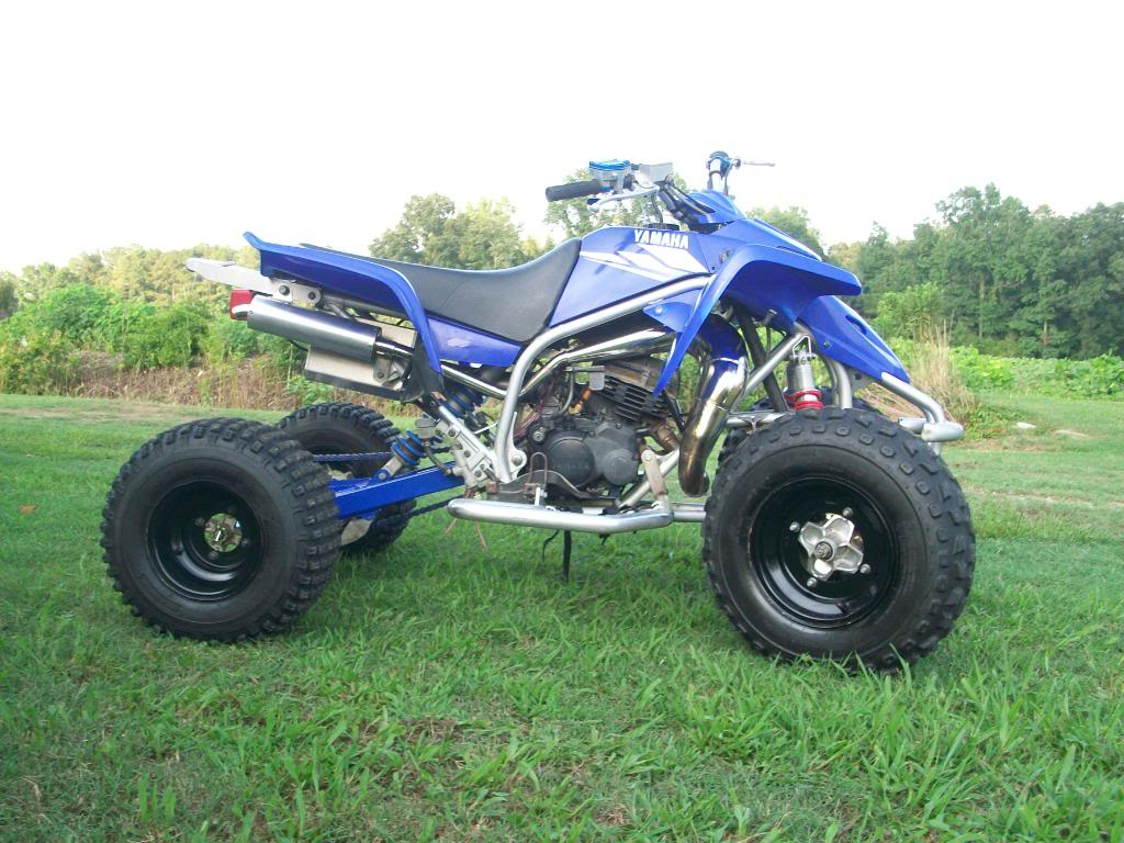

A Arms: ASR +3+1 Long Travel
Swingarm: Swingarm Shop +4
Steering Stem: Stock
Stabilizer: N/A
Axle : G-Force Adjustable
Carrier: Stock
Locknut: G-Force
Hubs F|R: Banshee Front / Stock Rear
Bars: Stock
Throttle/Clutch Lever: Stock PC'd Blue / MSR AOF
Grips: Scott Hurricane
Nerfs: Tusk
Bumper: Stock
Grab Bar: A/M (not sure?)
Front Shocks: Works Triple Rate YFZ450
Rear Shock: ATC 250r
Brake Lines: Polaris Predator Fronts
Rotors F|R: Banshee Front
Rims F|R: Stock
Tires F|R: Stock / 18" Turf Tamer
Body:
Frame: Stock
Plastic: Stock
Graphics|Seat Cover: Stock
Number Backgrounds: N/A
Handguards: N/a
Bar Pad: N/A
Fuel Tank: Stock
Engine|Drive System:
Cylinder|Head: Ken O'Connor ported / Ken O'Connor redesigned
Bore & Stroke: 67mm / Stock Stroke
Displacement: 195cc
Reeds: Boyesen Dual Stage
Carburetor: Keihin 35mm Airstriker
Air Filter|Box: UNI / CFM Alum Box
Pipe|Silencer: Trinity Racing
Clutch|Plates: Stock / Stock
Gearing F|R: 14/40
CDI|Killswitch: Stock / Stock
Cooling: Air Cooled

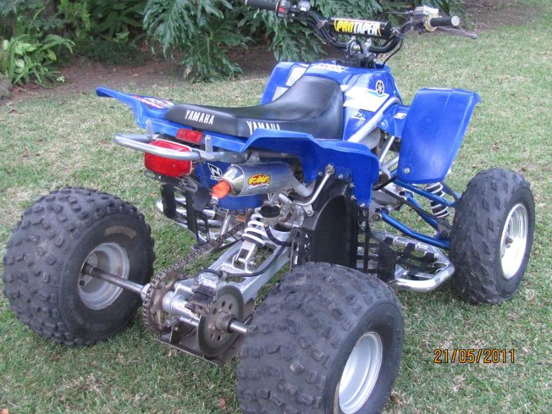

Other: Gotta HotRodz +4 waiting to be finished...

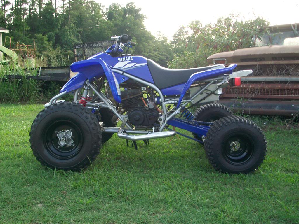

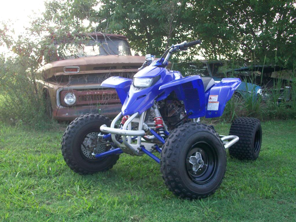

A Arms: YFZ 450 custom mounted
Swingarm: Extended 85mm; reinforced
Steering Stem: Stock, raised with upside down polished clamps
Stabilizer: N/A
Axle : Durablue Banshee 2+2
Carrier: Stock with added grease nipple
Locknut: Durablue billet
Hubs F|R: Banshee|Stock
Bars: Pro Taper ATV Hi Rise
Throttle/Clutch Lever: Stock Polished
Grips: Pro Taper
Nerfs: Airtime (SA Brand)
Bumper: Stock
Grab Bar: Stock
Front Shocks: YFZ450 custom frame mounted
Rear Shock: Honda 400EX
Brake Lines: Banshee
Rotors F|R: Banshee / Banshee
Rims F|R: YFZ Alloy / Stock
Tires F|R: Dunlop YFZ Stock / Kenda Klaw
Brakes: Front: Banshee Calpers. Rear: Kawasiki Gpz400 System
Splindles: Raptor 660 Alloy
Body:
Frame: Argent Silver with modified A-arm arm and shock mounts
Plastic: Stock; Meshed front hood
Graphics|Seat Cover: Factory Effects Kit
Handguards: my knuckles
Bar Pad: Pro Taper
Fuel Tank: Stock
Other:Alluminium Frame Boot Scuff Gaurds
Cylinder|Head: Custom Ported, Auxillary Boosts; Redesigned combustion chamber
Bore & Stroke: 68x57
Displacement: 207cc
Carburetor: OKO 30mm. 160 MJ, 58PJ, JJH needle
Air Filter|Box: No Toil filter |Stock Airbox, Lid removed
Pipe|Silencer: FMF fatty, power core2 (Recoated With Zinc plating)
Gearing F|R: 14/40
CDI|Killswitch: N/A
Cooling: Air
Other: Boyeson Dual stage power reeds; 1mm base plate spacer. Wiseco Prolite Piston, Vesrah Conrod, +4 timing

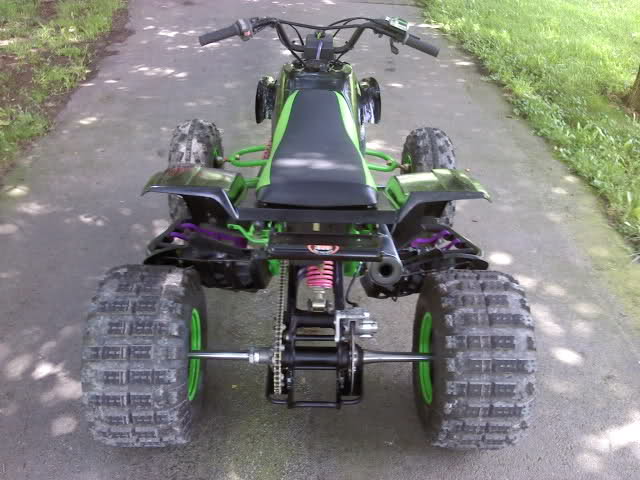

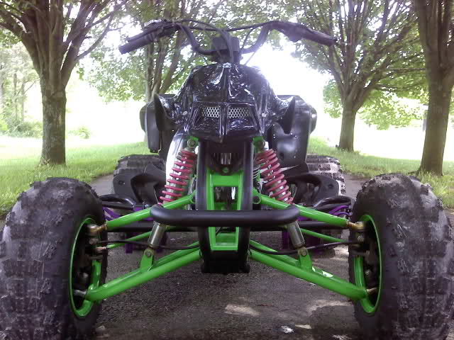

A hard working machine, functionality is 1st priority.
A Arms: SMS +3+1
Swingarm: Stock
Stabilizer: N/A
Axle : Polished Banshee
Carrier: Stock
Locknut: Banshee
Hubs F|R: Stock/YFZ
Bars: Stock
Throttle/Clutch Lever: Polished/Stock
Grips: Pro Taper
Nerfs: AC PC'd Black
Bumper: Stock
Grab Bar: SMS
Front Shocks: Stock
Rear Shock: Stock
Brake Lines: +3 Terry cable, Motion Pro Shorty
Rotors F|R: Stock
Rims F|R: Stock, YFZ
Tires F|R: Artrax 21x7x10, 20x11x9
Body:
Frame: Stock
Plastic: Project Blaster Taurus V1 Fronts, 06 S.E
Graphics|Seat Cover:06 S.E, Black,Green
Number Backgrounds:N/A
Handguards:N/A
Bar Pad:N/A
Fuel Tank:Stock
Cylinder|Head: Ported, Polished ken oconnor redesigned head
Bore & Stroke:67.00mm/57.00mm
Displacement:201cc
Reeds: Boyesen Pro Series
Carburetor:Stock
Air Filter|Box:Twin Air, Stock Box with uni filters in lid
Pipe|Silencer: Dyno Port
Clutch|Plates:Stock
Gearing F|R: 13/40
CDI|Killswitch:N/A
Cooling: Air
Other: YFZ heel guards
