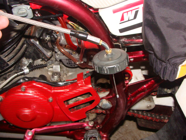

i just bought one of those, it fits my 34pj, which also uses the same jets as the 38's, the cap and cable threads should be the same
the one i got looks exactly like what you show in the pic.
here's the exact ebay link i bought mine from...............
Mikuni Cable Adjuster I M22 10 3 | eBay
mikuni 45° cable holder mikuni part# I-M22-10-3
here it is on a keihin 33/35mm airstryker using a rappy250 braided cable..........
the brass coupler will unscrew to accept female thread end cables \/
brass coupler removed and rappy250 cable installed \/
no, thats not my blaster /\

The link is for just the brass piece or the whole angled piece?
the whole angled cable adapter, i just mentioned the brass piece as it will come off to fit either male or female threaded cable ends
you get everything but the cap in the first pic
Awesome. 6$ its worth a try.
