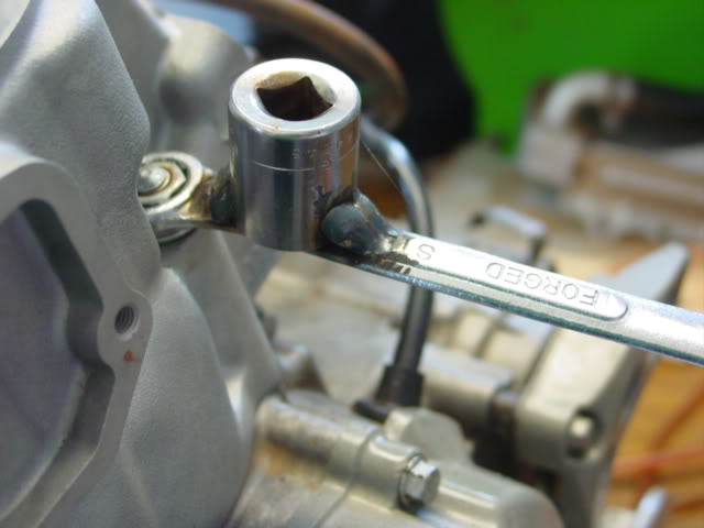

Theres a special short wrench that you use along with the torque wrench. I have one but to be honest i never use the damn thing. They sell them on ebay and rockymountain atv to get at the bolts.
Yes but I just learned that the crows foot needs to be at a 90* angle as not to change the distance of the bolt or I will read improperly.
On topic I would always opt for oem basegasket or cometic
i use cometic gaskets on everything i have and have had no problems with anything. my mom always gives me these long talks about spending money, but she doesn't understand that when i buy top of the line stuff that it is to keep us from having to spend more money on replacing stuff later.
At 20ftlbs?works on my blaster,kdx,and my little brothers rm250 with no problems.
A fool and his money will soon part...if you want to spend money on something you can fab up with some old jap junk tools and a couple spot welds then be my guest.i personally dont see much point in buying what i can build or make.
Maybe if you were torqueing heads bolts on sbf or maybe lug nuts it wouldnt be safe but at 20 lbs youre more than good.unless youre a horrible welder and in that case dont bother but any dip sh*t can weld one of these up and it be reliable.
