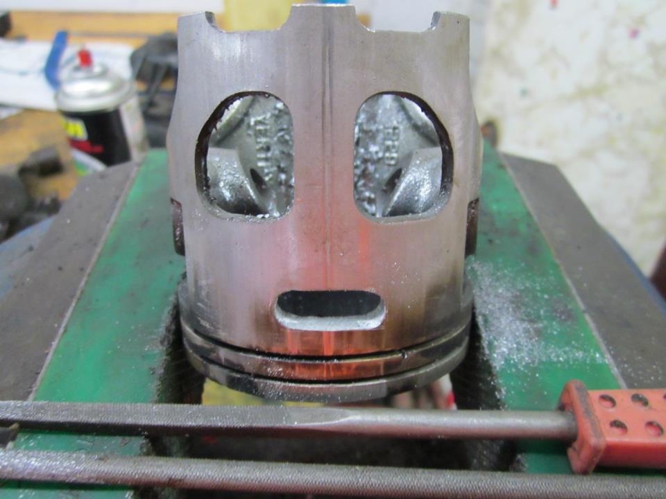

This piston we modified in the boost port thread is a Vertex.
It has held up pretty darned good. What would you like to know about it?
Steve

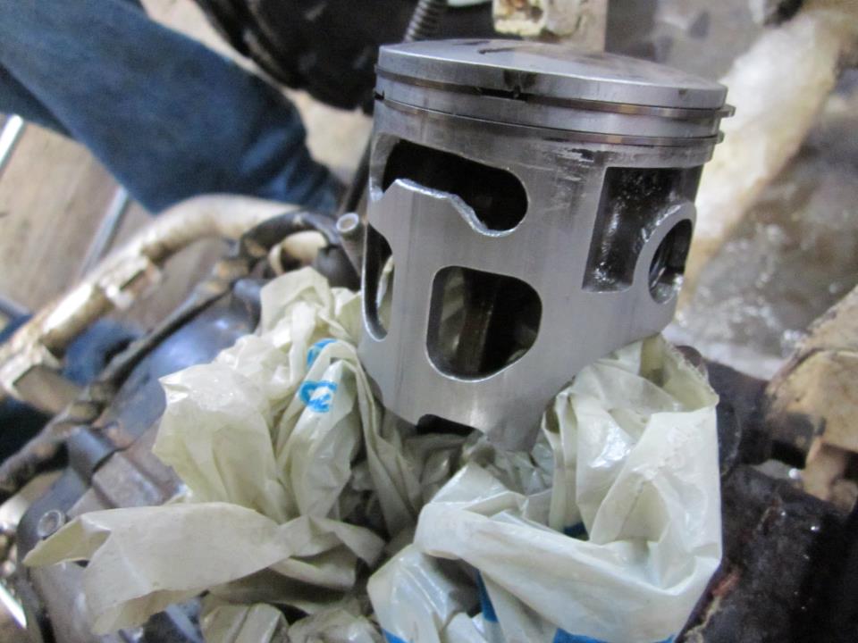

Actually "ProX" pistons are manufactured in Japan by "Art",which manufactures original equipment murchandise (OEM) pistons for most manufacture's.
Good stuff too! I just re-bored a 2000' RM80 and fitted it with a ProX piston. "Made in Japan" marked on the piston.
