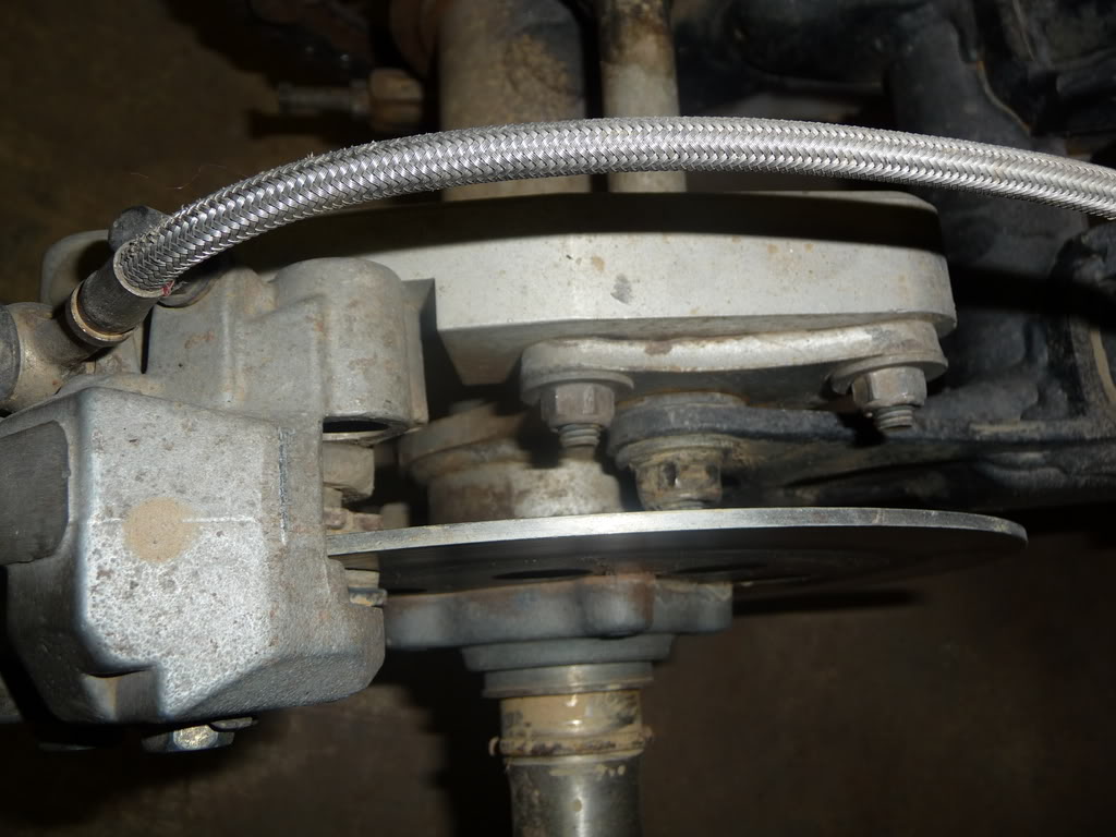

i had the whole carrier so i cur the mount of and welded it to the blaster carrier. however i did make a bolt on setup just out of some 1" box steel and just drilled 5 holes. 2 for mounting to the carrier. 2 for mounting the caliper and 1 in the center for the parking brake adjuster. it just takes some work to align it and drill the holes.
hope this helps
So the pic you posted is just the welded carrier and nothing to do with the "bolt on" bracket right?
I think this will be an easy deal, I was hoping to design something that used the stock caliper mounts and then bolt to it...hoping I don't have to have a massive plate in there somewhere...lol

yea if you want i can take a pic of the setup i got from ecatv they make a kit that is bolt on and uses the banshee/warrrior carrier and then u can have some idea of what you have 2 do

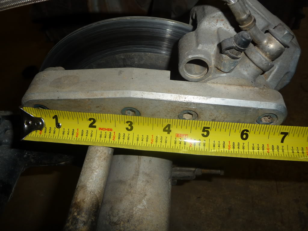

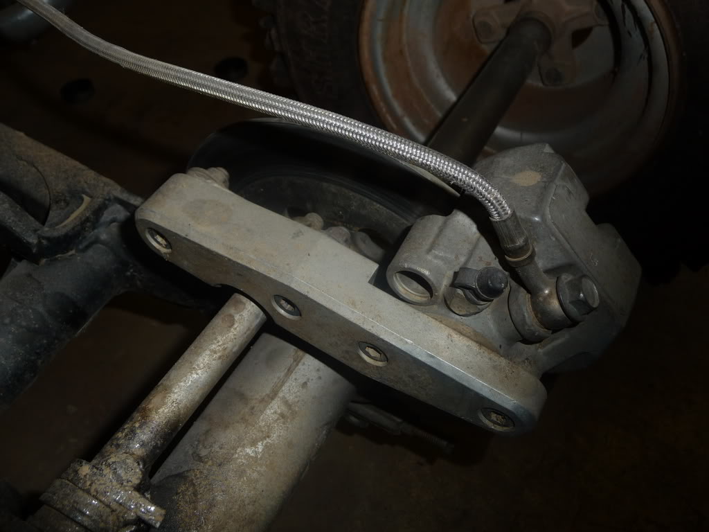

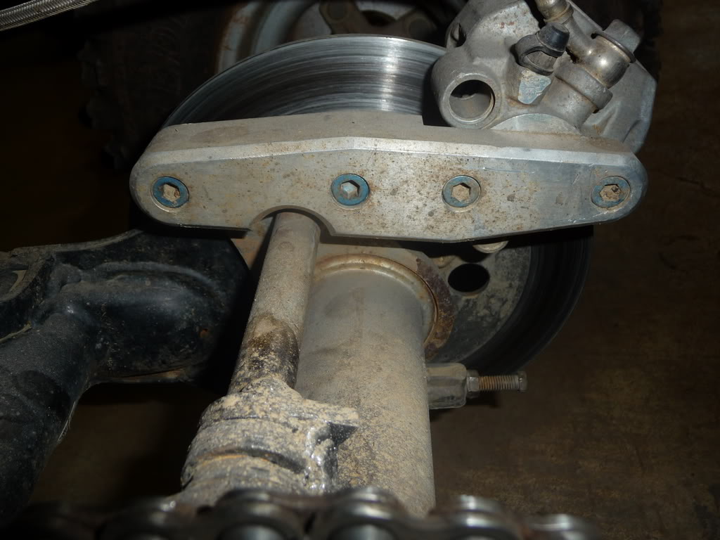

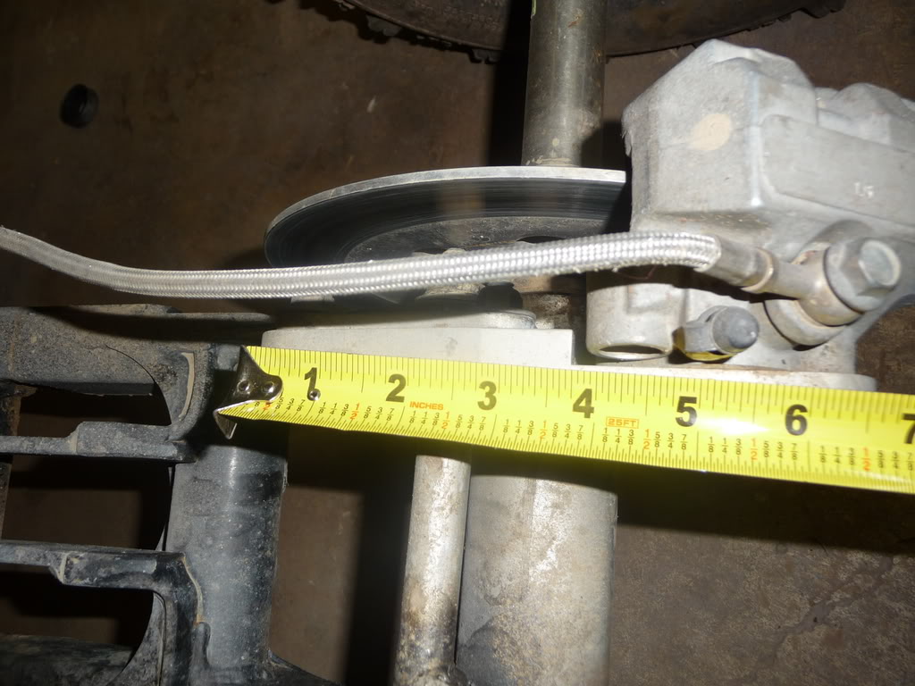

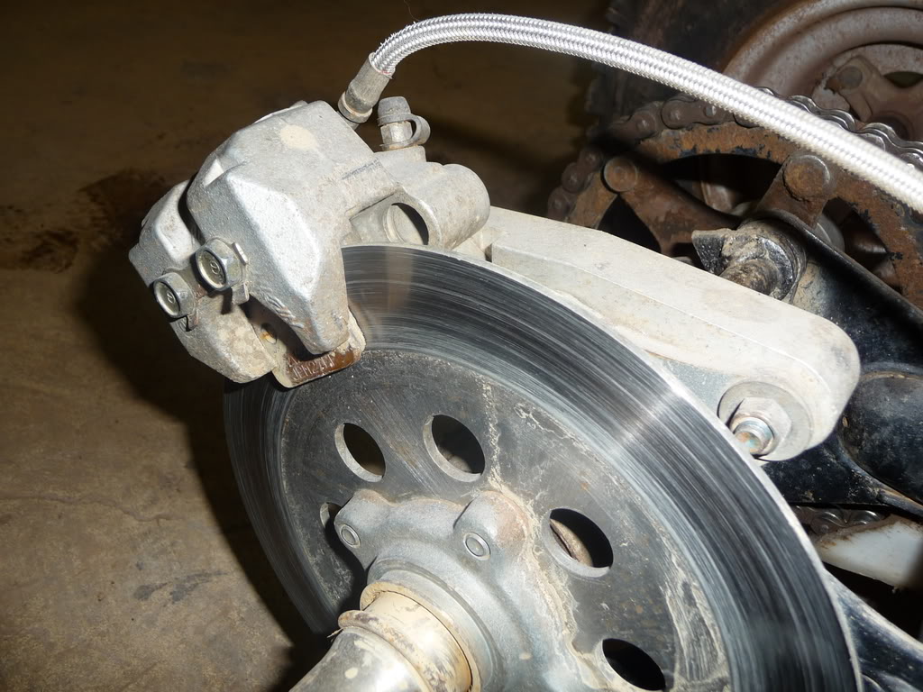

okay here are some pics of what i have on my blaster now. looks to be about 1" wide then goes to 1/2" in the middle. there are 4 holes for the hardware and one you won't see on the other side that is where the parking break end can go in. its not to big and it works well. hope this helps you.
Hell yeah that helps! I sure appreciate the time and effort man....a bunch!
That looks really clean other than having to be so thick but that works for me as is.
Thanks again for the pics!

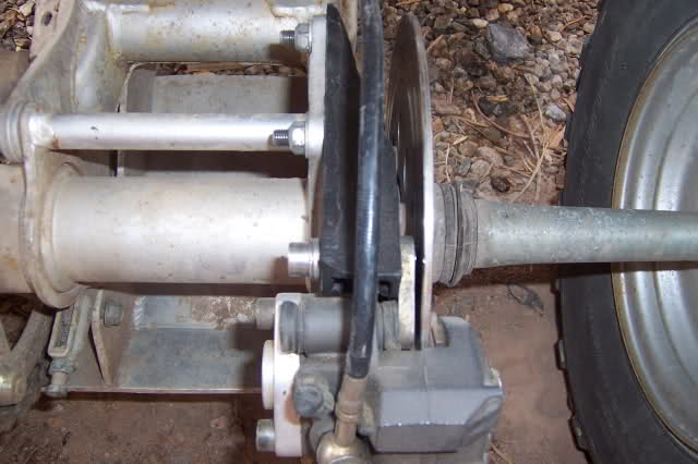

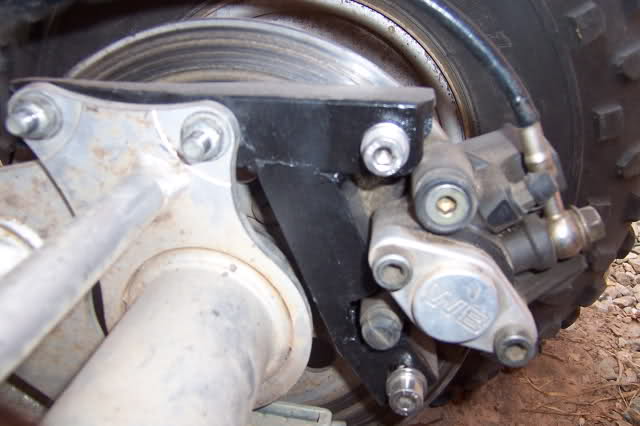

This is a picture of a bracket I built yesterday from some angle welded in a rectangle. It is on my 98 and the brake came from an 03. It uses all the original hardware except for the allen heads, they are a little longer than the stock ones. It allows it to float still. I replaced the trenga one I had because I couldn't get it to bleed. It works good.
