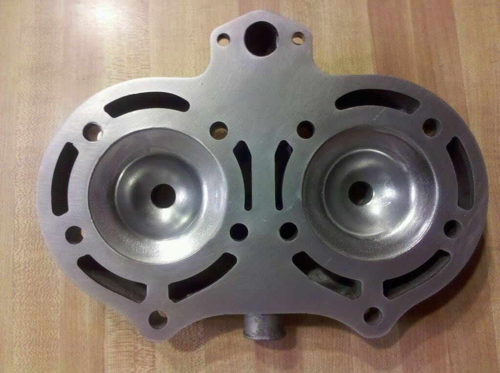

Went out to ride the shee and seen a couple drops of coolant on the floor.Started looking and found it to be #4 stud leaking coolant up the threads nothing crazy but its a brand new build so any leaks are unacceptable.
Put a little permatex teflon sealer on the stud and retorqued it and it quit.Well being as paranoid as i am i decided that a 26$ oem gasket was cheaper and easier than an engine rebuild (DUH RIGHT) and for the life of me i cant see why it was leaking!
I sent the jugs off to ken who fixed the sleeves,pinned the sleeves,and resurfaced the jugs so i know theyre good but i didnt resurface the head.There was a little dip i guess u could call it in that area of the stud.So i took 220,320,400 grit sand paper on a big huge thick peice of glass and resurfaced the head by hand and got the head almost flawless but am still paranoid since ive never did this should i go ahead and have the head shaved for reassurance and the little bump in compression or is the clymer manuals way of lapping the head sufficient?
From what i can tell it appears i caugt it in time and wasnt burning it in the combustion chambers because the pistons had the usual carbon build up.
What you guys think?I ordered a brand new oem gasket instead of the K&S that was on it.
