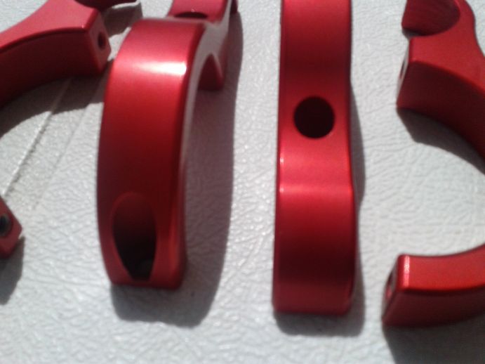

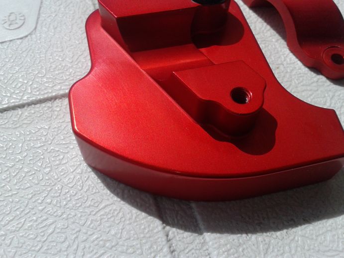

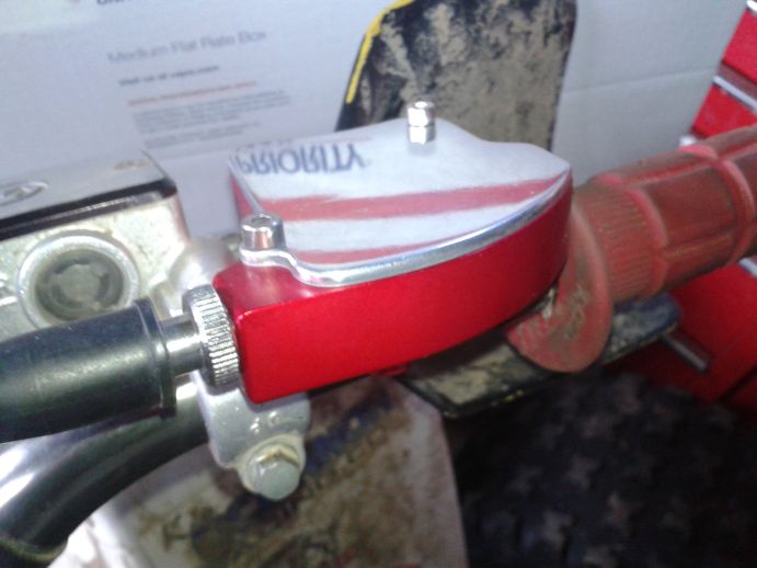

Just got a call from Ryan, my parts are done and on their way back to me....talk about a quick turn around !!!!
and they look amazing.
link to gallery:
Gallery: Colored Anodizing: Deep Red - Ryan's Anodizing
appears they're going to match the red anodizing on my elka shocks and rezzies perfectly I:I

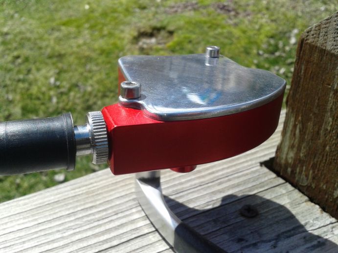

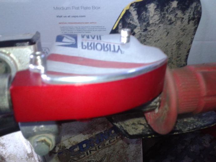

before and after
rezzie clamps
moose billet thumb throttle
Thanx Ryan, i'll holler when they arrive !!!

WOW, Ryans work is simply outstanding !

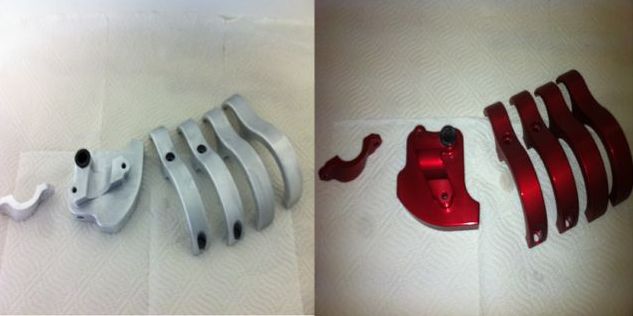

if you didn't know i had these stripped and re-anodized, you'd never know........
went from this....
to this..........
any of you guys need anything anodized, i highly recommend checking out Ryan !!

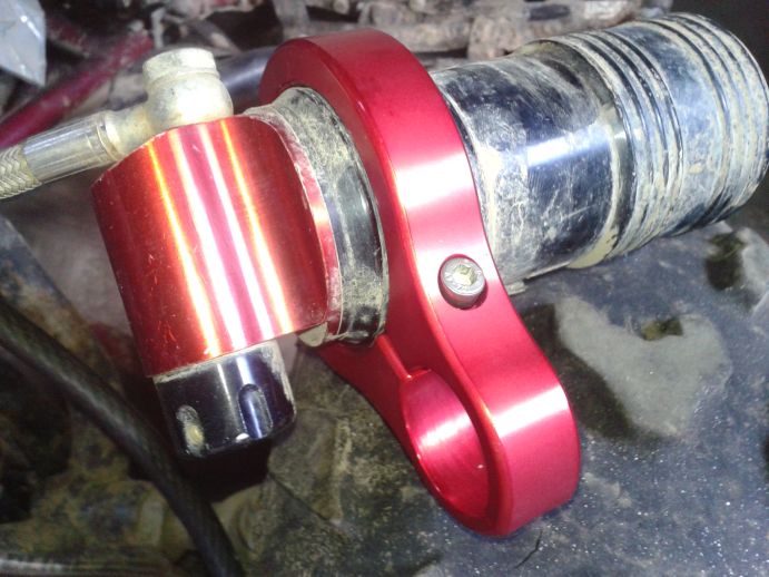

next on my list is new billet rear wheel hubs, and have them anodized red also
