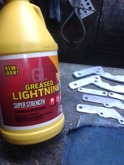

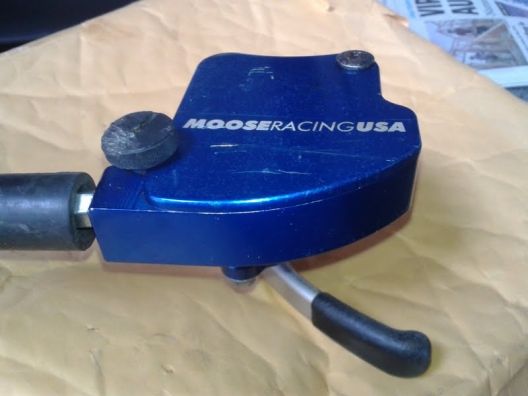

got some billet shock rezzie clamps last year and a moose throttle over the winter, but they're blue.
i ran the clamps as is last year as they're kinda down and out of sight, but this moose thumb throttle anodized bright blue sitting on top of my bars just wasn't going to cut it, so today I removed the anodizing "the Dualstroke way"
(thanx bro !) using "Greased Lightning"
started with this..
grabbed some Greased Lightning from the dollar store..

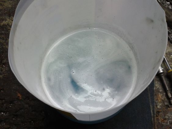

not long and you start to see some bubbling action...
pulling the parts every 10 minutes or so to check progress,
anodizing partially removed..
after about an hour i ended up with this..
i'll post more pics after i get them all polished up I:I

it says right on the back of the bottle "not for use on aluminum/anodized aluminum"
