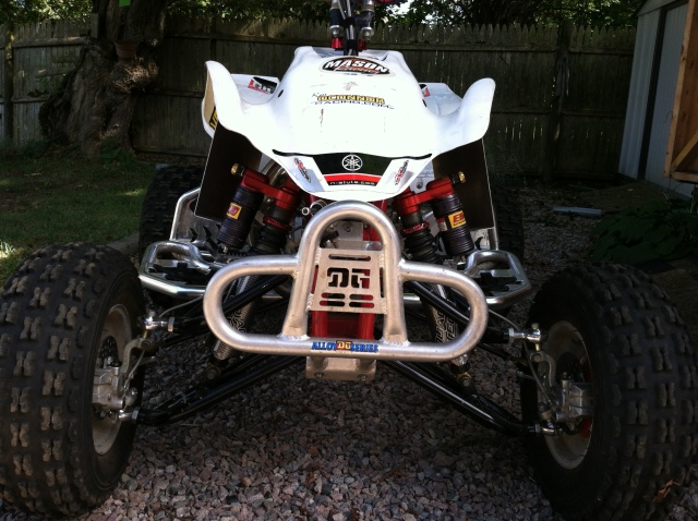

Great info Dirty!!! You summed it up perfectly!! I run the pro x arms. I prefer the heim joints however they do require more maintenance to keep them clean and last a long time.
Here is a pic of my ASR +3+1 Long travel pro X arms. I run shocks off of a yfz. I believe they are 16 inches eye to eye. ASR makes a very nice quality product at affordable prices. Can't beat them. imo
