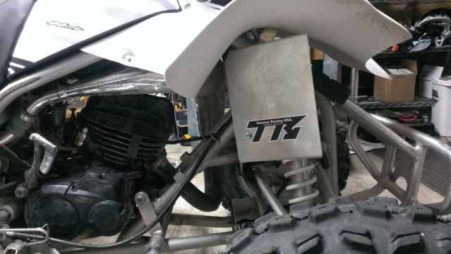

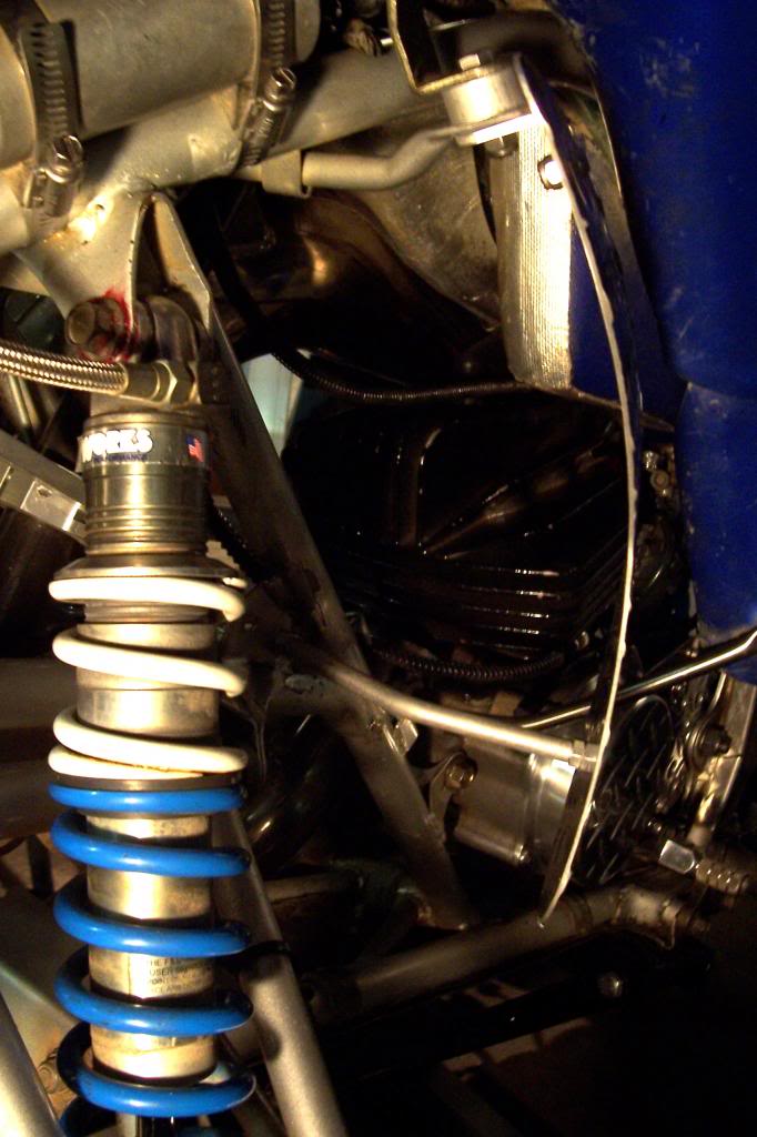

When i get home on Monday I'll post pics. I know it's internal heat that kills motors. Hence why diesels last allot longer but if I'm wot for miles id like the xtra cooling a scoop does, i can't see in any way scoops affecting running temp at slow speeds. Plus i got a nice spot for stickers. Some how we got off subject . Any how scoop looks good 79 bronco. You do "clean work" ...
