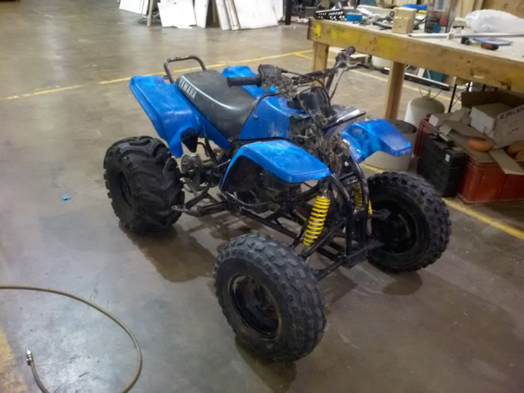

It got delivered to my shop today.
It needs some TLC, to be expected for a 300 dollar blaster. Bike wouldn't start so I started digging into it. Found a broken reed petal. The good news is it has good compression and the piston looks fairly new. I haven't leak tested it yet of course. I will do that after the boysen pro reeds to in. We found out it has a Paul turner pipe that has been painted black. They never jetted for it though :o Carb had stock jets in it. Probably why the piston was just replaced. Thank god the reed petal broke! So I ordered a uni air filter, reeds, tors removal kit, gaskets, and a couple other small things. The plastics look like a good candidate for paint. Shouldn't take much to get it going.
