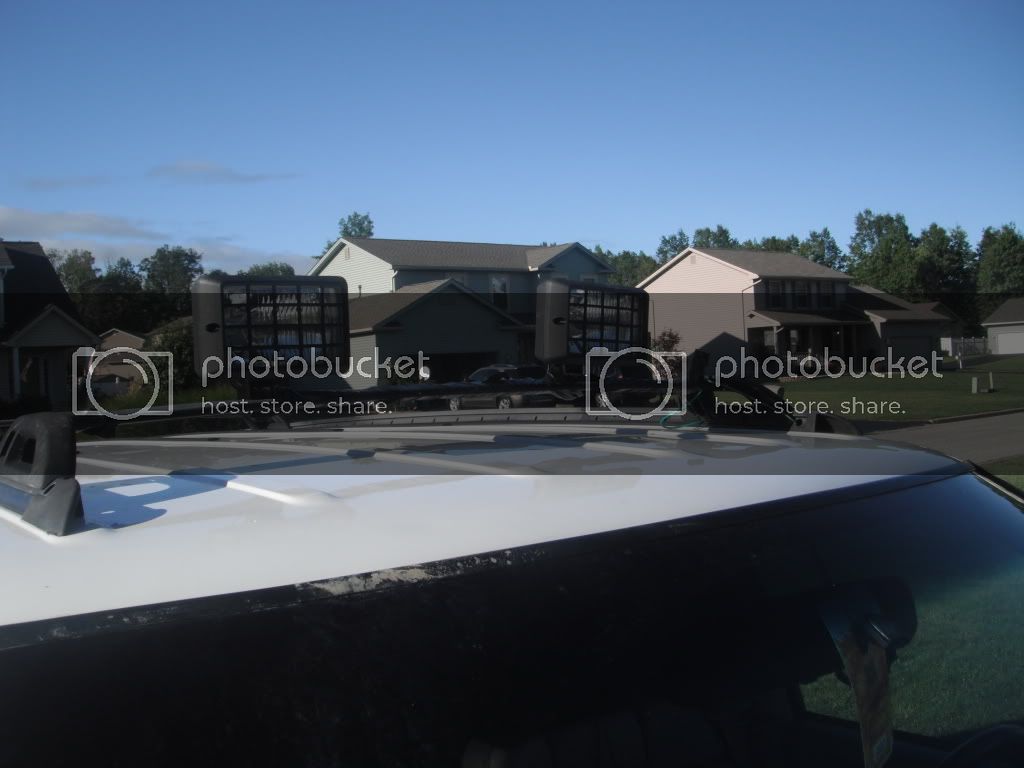

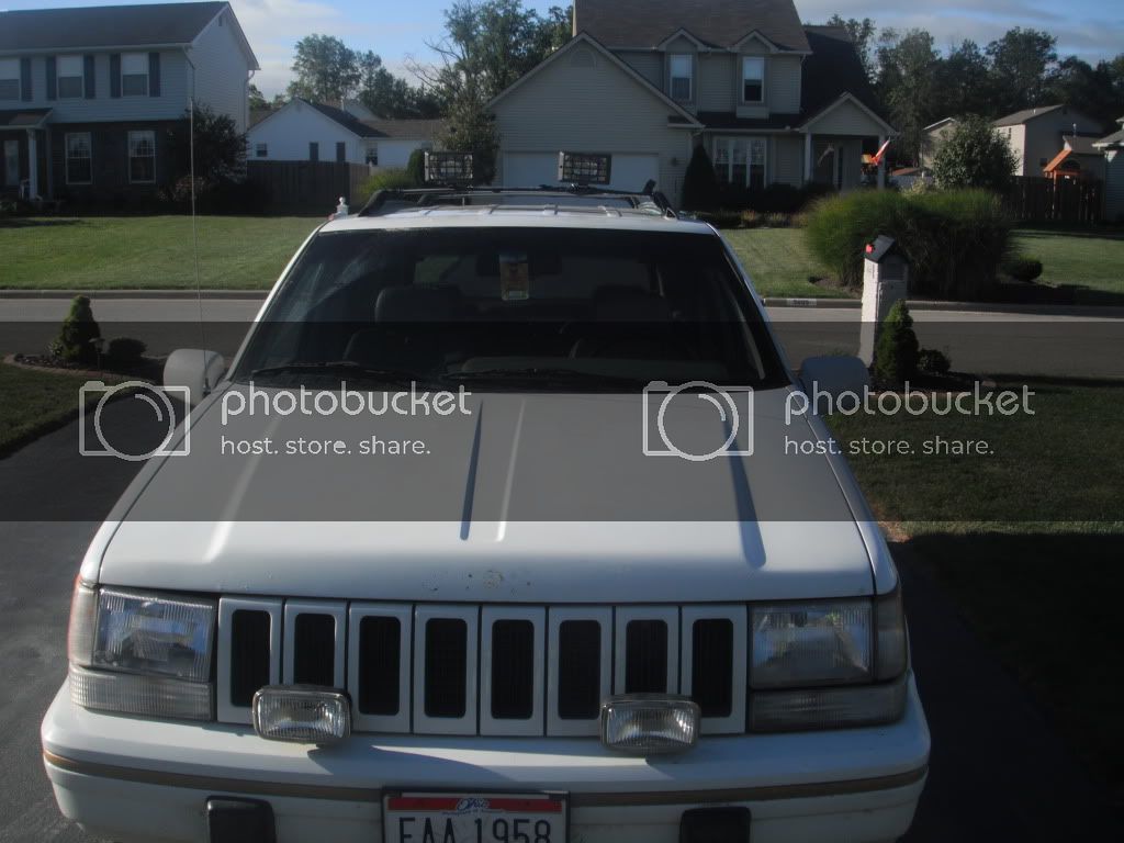

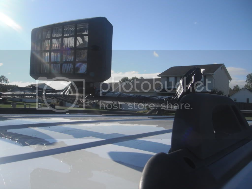

Some friends and I set these up last night, pretty straight forward installation, hardest part was drilling through the rack to get the lights mounted. We have all the excess wire taped down to the rack in case you guys are wondering why its all taped up lol I'll grab a night shot later
What do you think?
Nice. How bright are those lights? I never mounted any there on my Jeep. Is there a way to run the wires through the rack? That would give a cleaner look and the tape is going to peel with time.
They are pretty bright, and I plan on getting some brighter bulbs for them soon.
there isnt a way to run them through the rack, but i could make it look clean if i drilled a hole in the roof to run the wires but it might cause a leek.
So if the tape peels i just retape i guess
not the cleanest but it gets the job done. I would probably get another set. i think 4 would look better up there...lets see them night shots....good job
are they the ones from auto zone with the cover that says "baja champion" on them?
if so I just picked up a set of them for my jeep as well...
I say 4 forward and 2 rear and 1 each side but yeah if you just drill a roof hole run your wires and use flowable silicone to seal it it won't ever leak just use a rubber grommet so the wires don't wear on the bare metal hole and cause a short looks good bro get a lift under that beast already
I would have gotten 4 lights just didn't have the money its 22 for a set so it might be a little while. I actually was considering a hole in the roof but wasnt sure on how to seal it.
Lift won't be coming for a long while but i want one badly just gotta manage to get a job first
Thanks for the comments guys
Hey bro....I was thinking they make like 2" or 3" wire loom...mabye you could get some black and cover it from top side and then use some black zip ties on the ends and then a couple places in between to cover it. it would def look better than the tape...

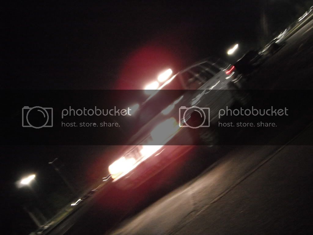

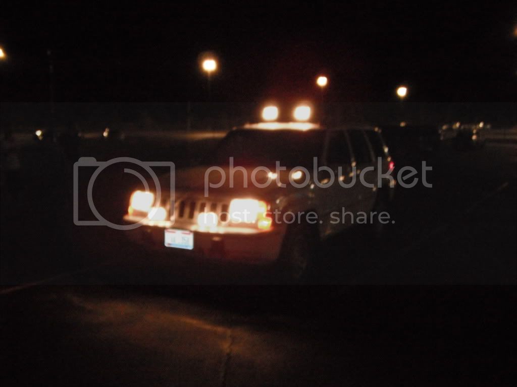

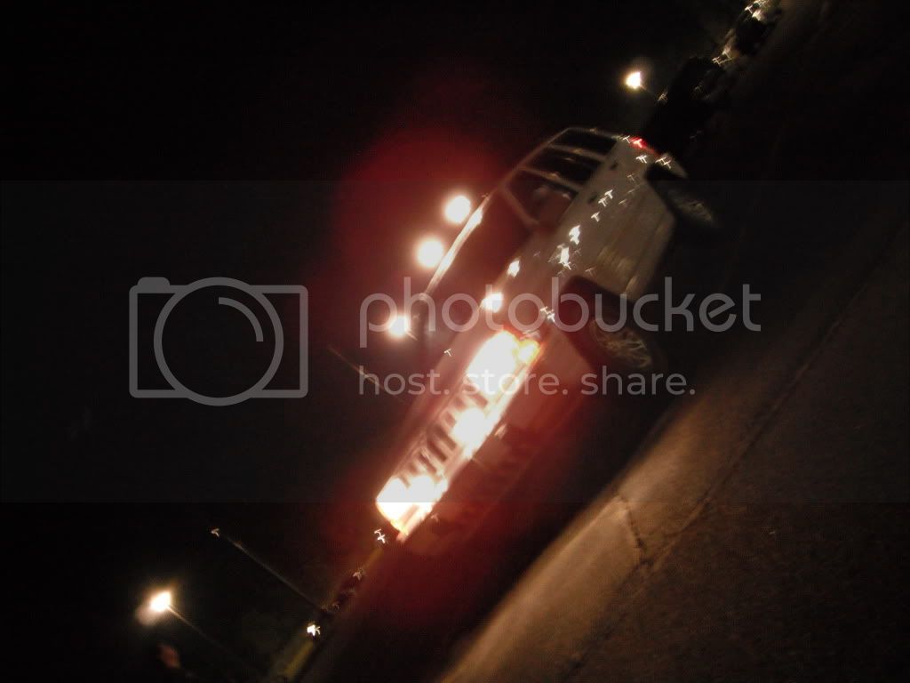

Wow man that looks really clean, really tempted to do that.
But I think I'll just leave them how they are for now because eventually I'm gonna move them down to the bumper, after I get a roof rack on top and mount some Hellas or KCs
Nice dude! I:I
Thanks man i love the lighs
I have gotten some weird looks with these, the best yet was i was pulling out at cics pizza and i turned them on just for the hell of it some guy passing in a honda just stared with his jaw dropped looking like a wtf moment lol i laughed my ass off
