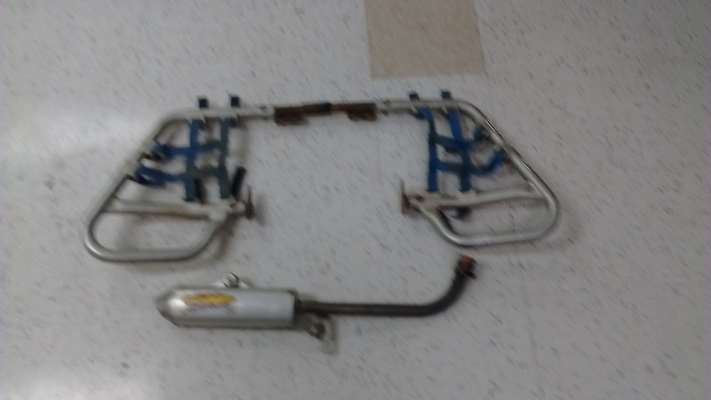

Nerfs and pipe

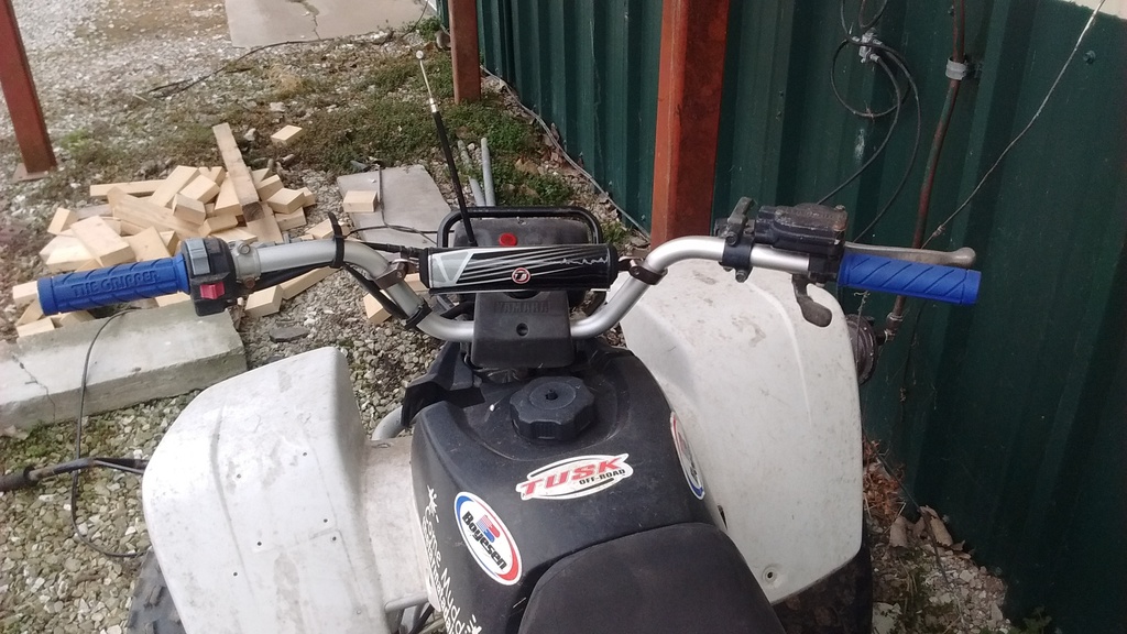

I haven't got much more done to the blaster other than getting my new handle bars on and started cleaning the carb. Is there away to bypass the ignition switch? Mine is broke from when my brother in law broke the key off. Also I should be sending my cylinder off to Ken in a couple of weeks for boring and porting It needs bored and the shop closes to me has bad reviews.

To bypass the ignition switch, just disconnect it. It works by grounding out the ignition when turned off. By disconnecting it, you remove the ground and the circuit is always open and ready.

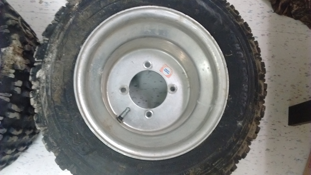

Finally got some parts. Picked up a intake boot, Douglas red label wheels with 18x11x10 ITP holeshot tires and and rear brake system for $90 all together.

Wheels and tires (wheels need to be cleaned)
