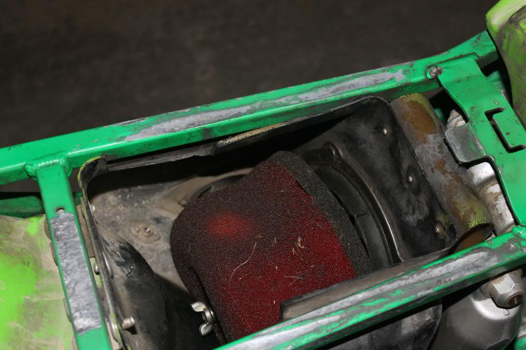

Anyways I believe this air filter is a UNI but not sure and it should be cleanable right?

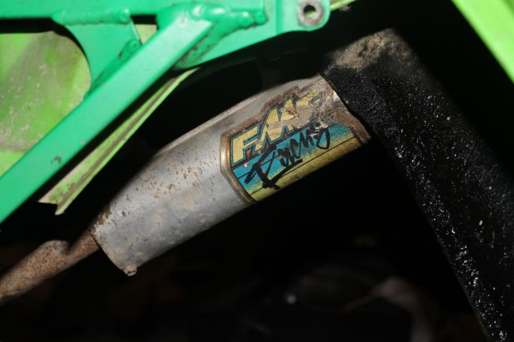

Ancient FMF silencer and for some reason the logo is facing the inside of the bike instead of the outside??

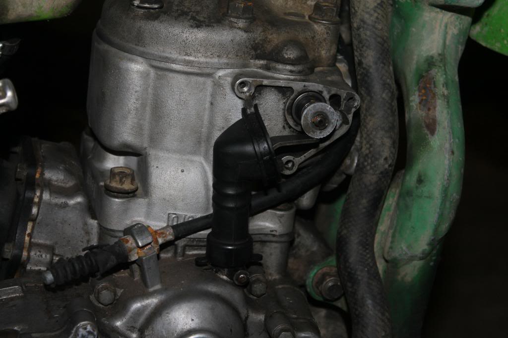

I'm really quite clueless as to what this black piece/tube is and what its function is?? Could someone also tell me if the clutch cable is supposed to be ran that way?

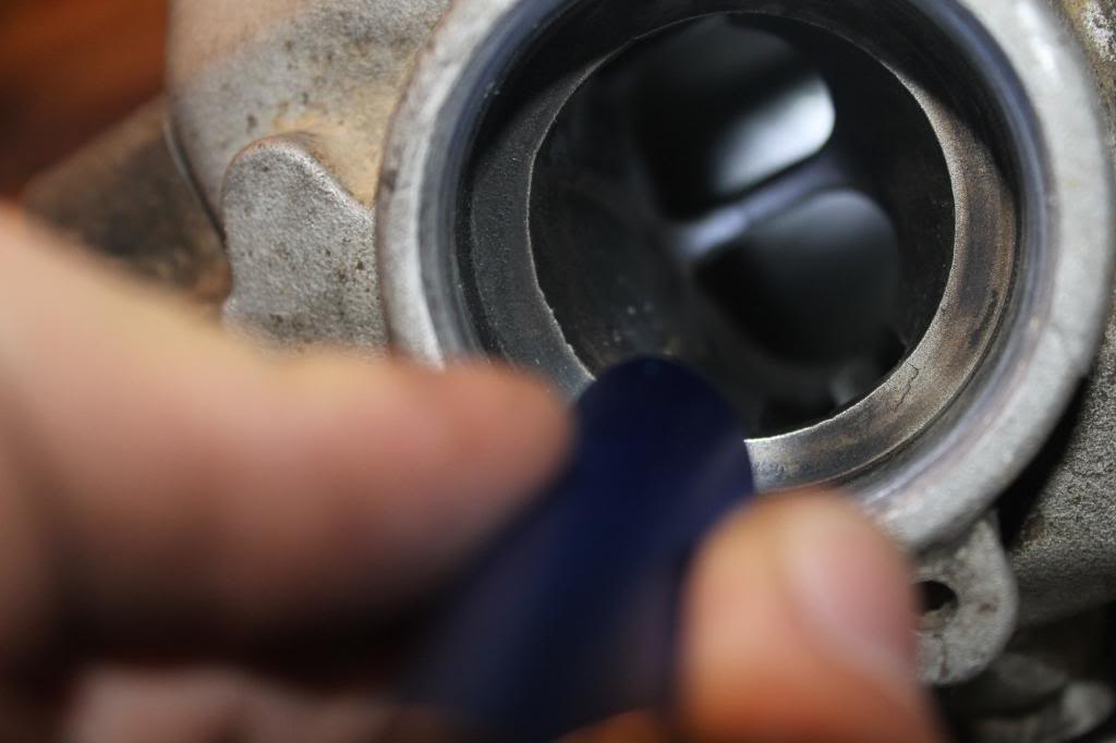

Is it normal for the spark plug to not be dead center in the cylinder?

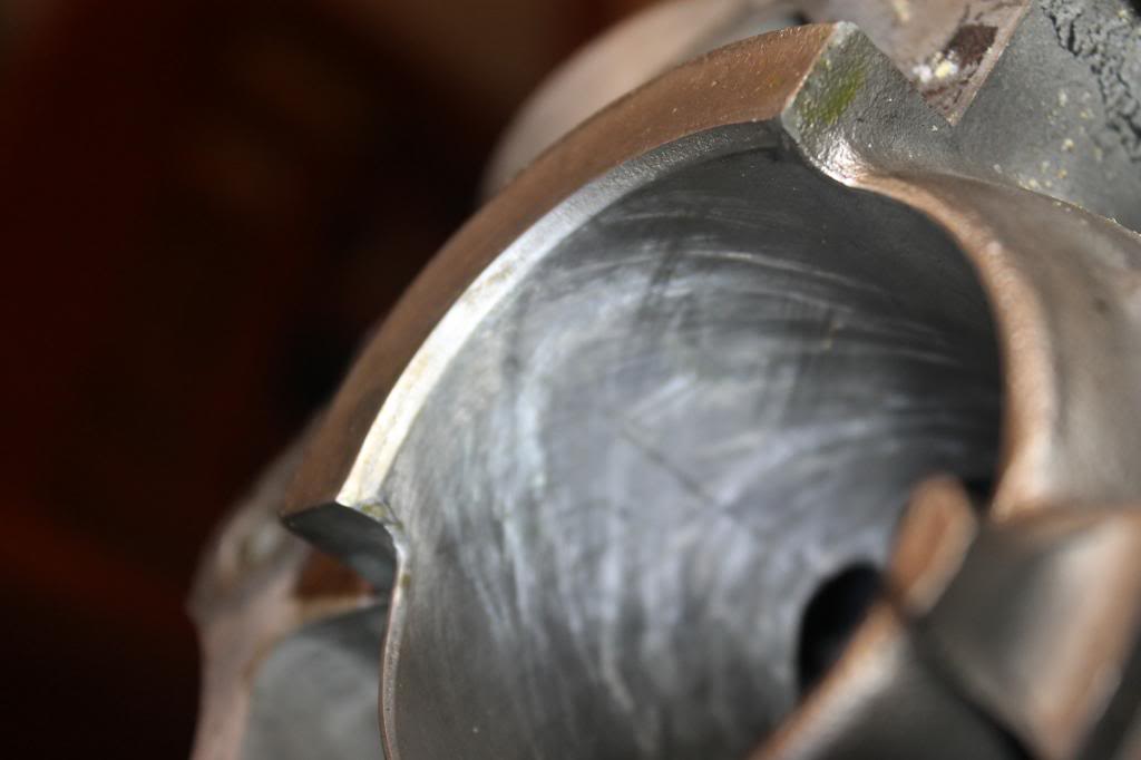

It has been honed and as from what I can tell from my digital caliper the bore is stock size

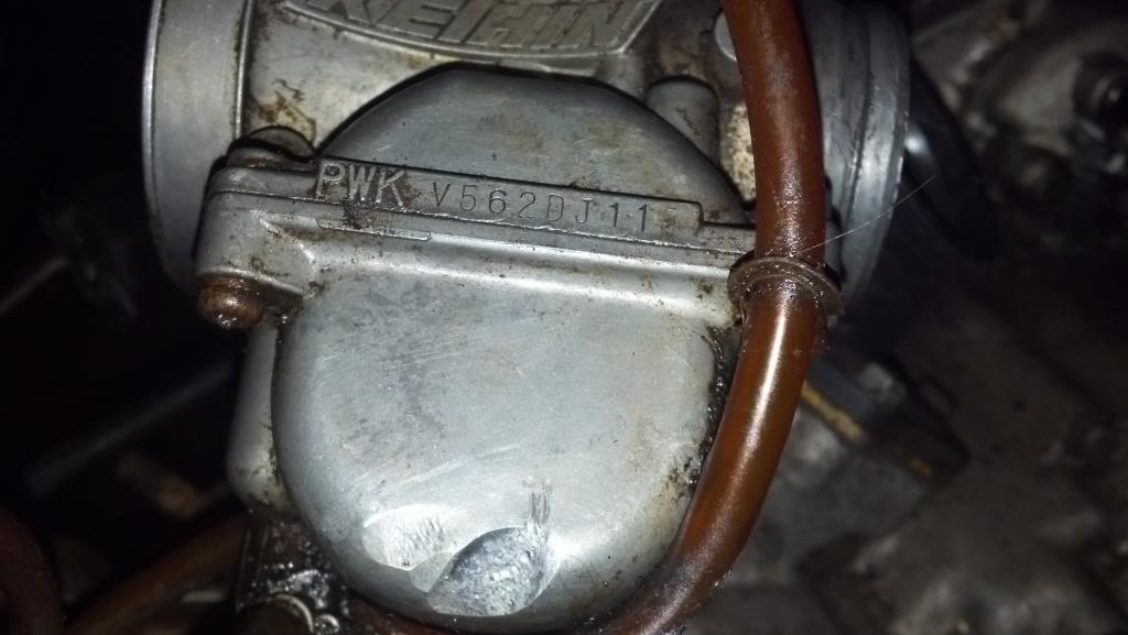

Will that massive chip in the bottom of the carb affect me any?

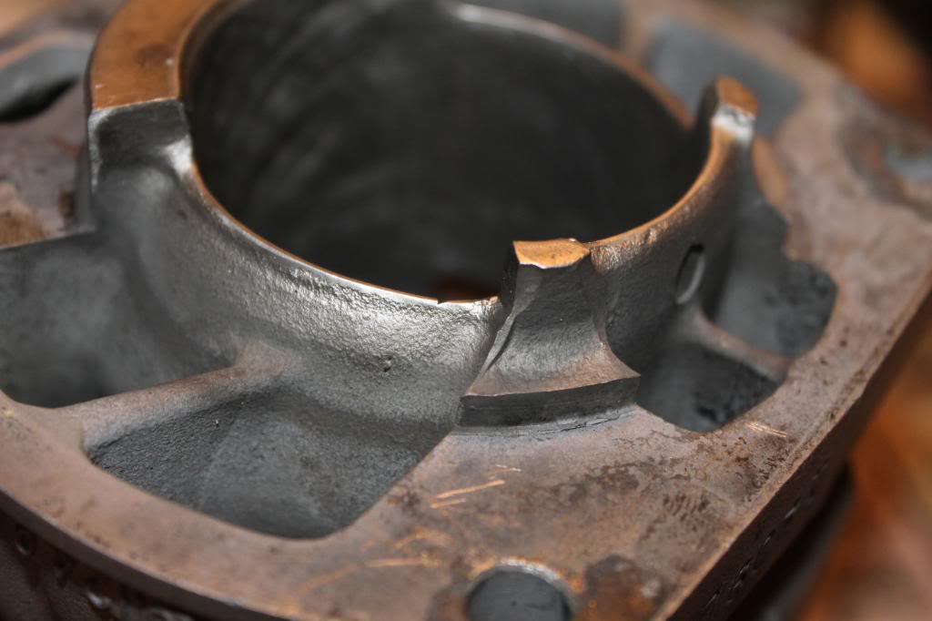

Or this tiny chip in the bottom of the cylinder?
Looks to as that black piece and where it connects is part of the power valve.Looks as thought you are missing a cover on it.You may need to reroute that clutch cable to make sure no tension is on it when you turn the bars.
I'll search the little box of parts I got with it see if I find anything that fits there
Are you missing the seat, swinger, the rear wheel and caliper? That filter should be fine.
I think you're right, that's where my buddy's is. Hes is like a 03, might as well take a look at powervalve to see the condition of it.
