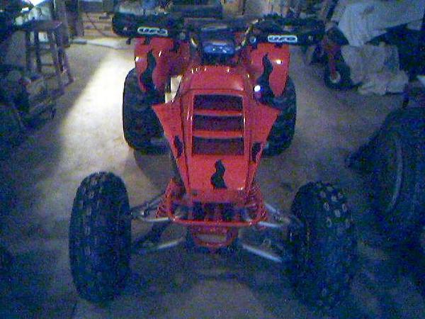

On my warrior I had mounted them on my bumper mounts, here's a couple pics. If you like these, let me know and i'll try to find a link to them. These are the ones I got on ebay.

Here's the same ones I have
