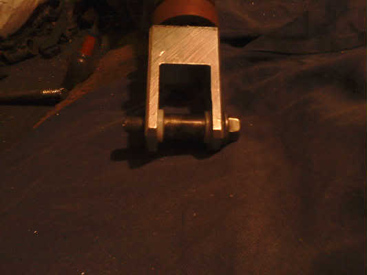

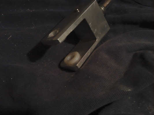

something i think this setup needs to have.. on the bottom mount you have a steel bolt running through the aluminum shock. this will be fine for a while. but after hours and hours of riding this will start to "oblong" the aluminum shock and it will develop play. i got some nylon type bushings and drilled them to work. on the inside of the bushings i cut a steel spaceer to keep them in place in the shock. yeah these bushings will wear out after a while. but i would rather be able to replace these bushings for a few bucks and keep the mount tight, then have it eat away at the actual shock. i attached some pics to show what i mean. with a little thought and a trip to the hardware store you guys can come up with something similiar or the same as this. for stock swingers you may have to use bushings on the swingarm mount being it is a bigger hole than my custom swinger with longtravel mount.
