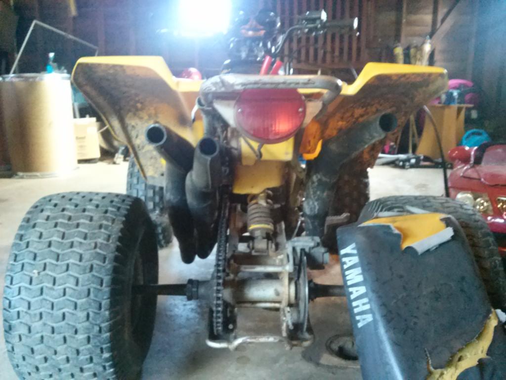

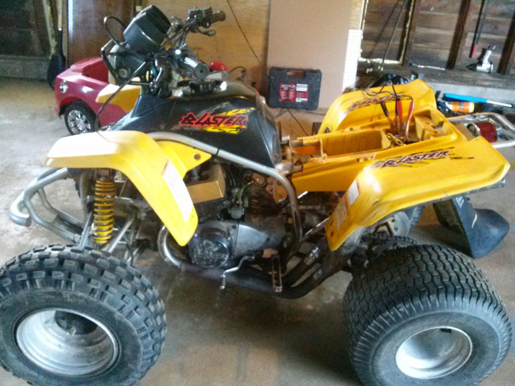

For those who haven't seen my wheeler heres a few pictures of it.
SO what's left you ask? Well the Carbs have been rebuilt but still have plenty of tuning to do. As of now 1 carb leaks because the float isn't at the appropriate level or is bent. So whats this mean? I'm pretty screwed until i can figure it out perfect.
Next is the exhaust. It's extremely loud to even ride you have to have ear plugs or muffs on. So that's the hardest part for me to figure out as i don't have anything to make a custom exhaust, my welder and welding skills are weak. Well, my welder isn't weak it's too strong for the exhaust and will burn through it.

I didn't put the motor in. I traded a junk vehicle for it lol.. If the motor has to come out i have to cut the mounts out.
looks to me like some weird expansion chambers and no silencers? not sure how that thing works. Do you know how it is setup originally on the Kawasaki? I bet its gonna rip!!
Its a 2 stroke, and I know for a fact those kawi triples mooove.. and yes they are loud.. That motor on a blaster u better be careful man..
Tractor tires are so i don't lift it up and do wheelies all the time i guess lol. I'm looking at baffles for it just a matter of figuring it out completely and time. Usually work 120+ hours every two weeks so lol.
