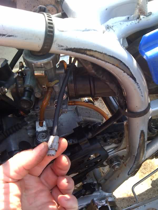

Here is the TORS unplugged.

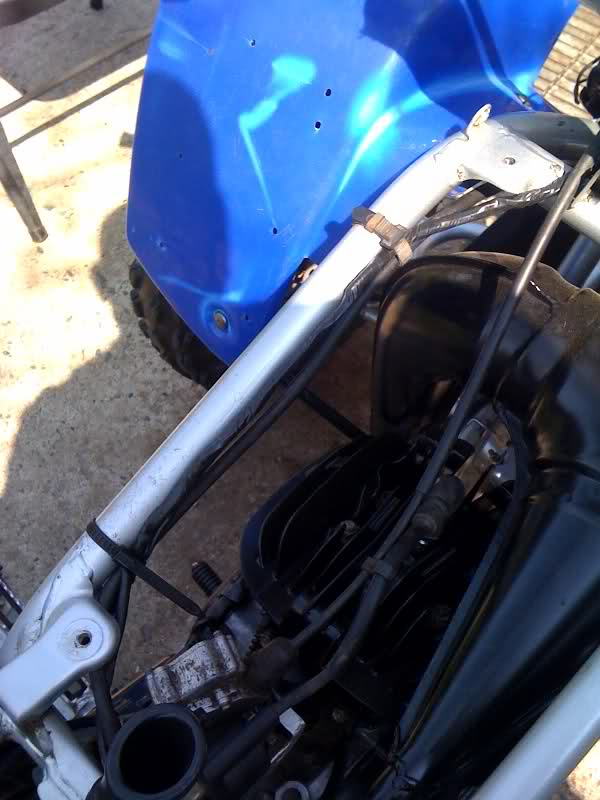

This is all that is left of the wiring.

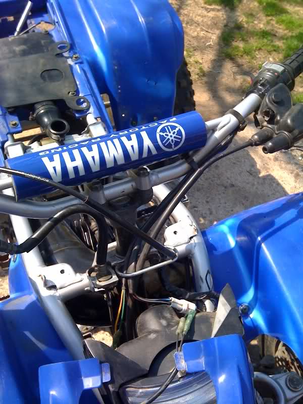

Up front.

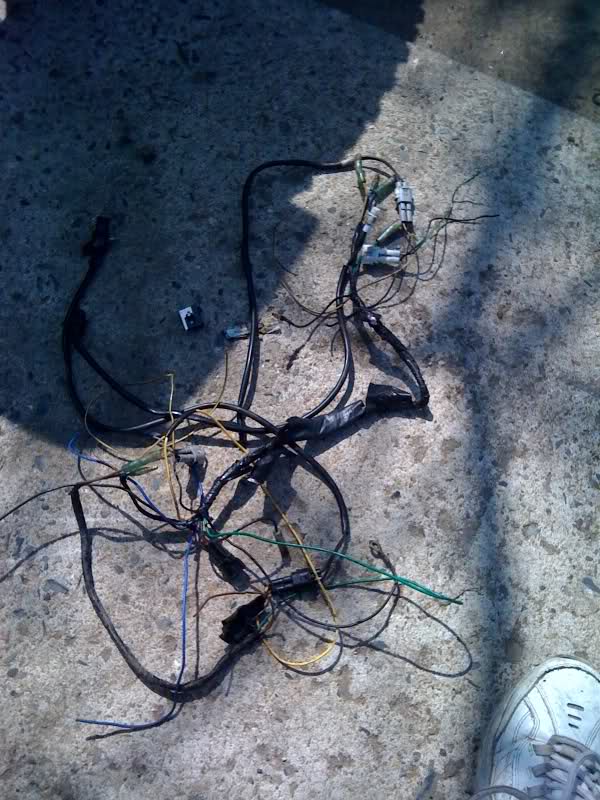

Here is everything I didn't need.
