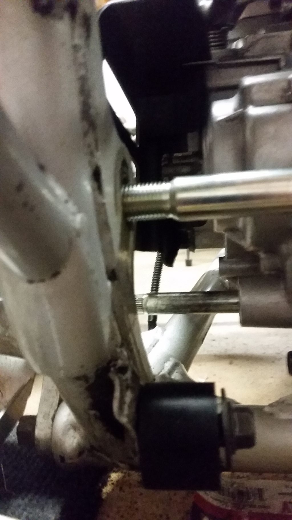

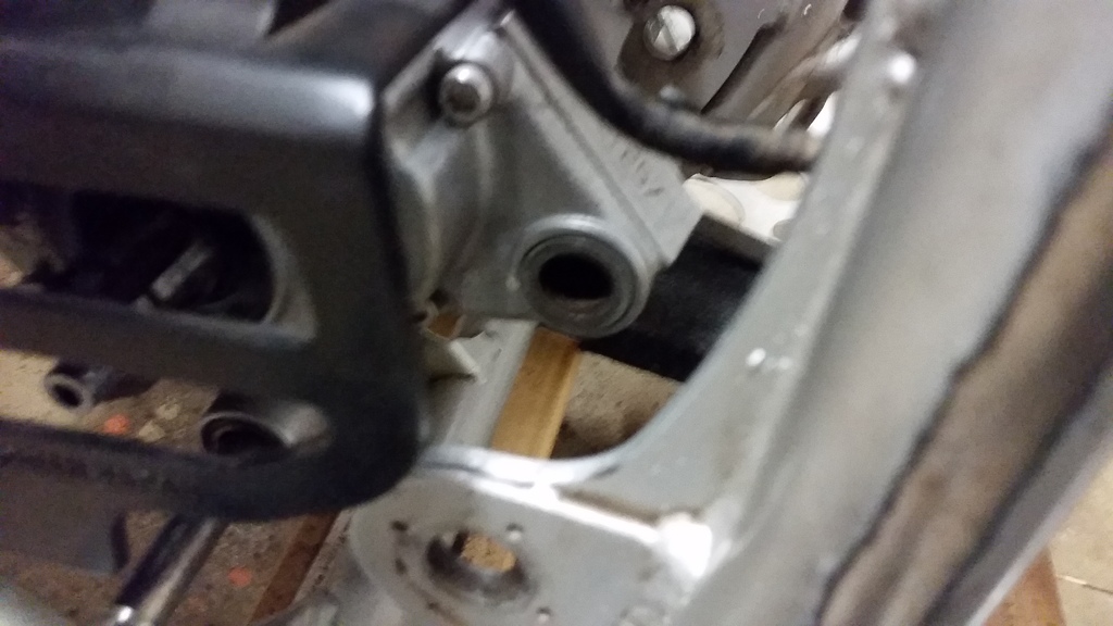

Nahhhh, I dont think the frame is bent. It's never been in a roll over or anything major, but my friend did like to ride it on its side 2 wheels, thats why im thinking its a bent tab... Im not sure, here are some pics i took while walking out the door to class. Gonna have to fiddle around tonight.
The second picture makes the alignment look way out of whack, first picture gives you a better idea of what it looks like.
Do you suppose it could be these metal bushings type things? It seems to start binding when it gets fully through these, its left some rub marks from the binding.
Edit: oh yeah, one more thing, the axle binds and doesnt line up correctly when inserted from either side, which makes me want to blame the middle bushings for the misalignment
Well I'm back at it, bit faster than I thought too. Bit the bullet and ordered a Tusk axle and American Star A-Arms. A good, hefty chunk of change. Found a guy near me selling Banshee parts dirt cheap, picked up the front wheel setup for a good deal.
I have the swingarm, all new bearings and lubed up, sitting connected to the engine on a table. I had to use a file and clean up the inside of the engine where the swingarm bolt goes through, I must have roughed it up good when trying to get the old swingarm bolt out. After some cleaning, the bolt goes in nice, if there is binding when I go to put the engine and swingarm on the frame now I will know its the frame that is tweaked.
