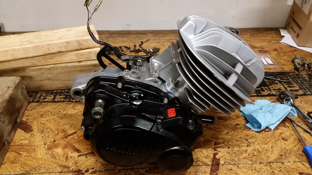

Well heres the engine, all put together and ready to go

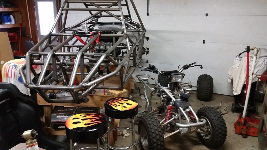

Heres what the frame looks like at the moment
Heres the frame next to my buggy frame, the a-arms are currently off the buggy. We're trying to get it off that damned wooden cart so we can take the engine out and sell it. Anyone interested in a 2010 Z1000 engine? 370ish miles only, wiring harness, exhaust, fuel pump, tach, custom airbox ;) hehe not the place nor the time... We just want more power, and of course we're gonna go with good ol' Yamaha R1 power.
