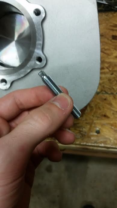

Well I have the new fat bars on with the controls, now I just need to figure out how to make a plate to hold the key. And at the risk at sounding like an idiot, which way do I install these head studs? It seems pretty obvious, I think the hex head goes up, but I've never done head studs before, there are no instructions (maybe because its so obvious) and I dont want to screw up this far in. Better safe than sorry. Also should I use any kind of locktite on these? I have blue and green on hand.
I figured that if I goofed it up i'd feel more dumb than just asking. Should I use any loctite? I've been looking but I cant find a definitive answer. Some say red loctite, some say dark blue loctite, some say none.

Put the studs in the head with some locktite and snugged them down. Anyone heard of putting High temp RTV gasket maker on a copper head gasket? Vito's instructions call for it (High Temp Silicone Sealer), seems a bit odd to me, I figured you just shoot it with some copper gasket spray like KenO in his YT videos. So I'll probably buy both just to have them on hand depending on what kind of responses I get.
