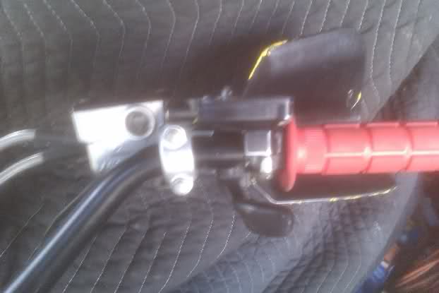

so as i mocked everything up yesterday, i found the brake clamp was mounting where the bars started to bend down toward the clamp, which put the lever on an unacceptable angle

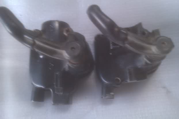

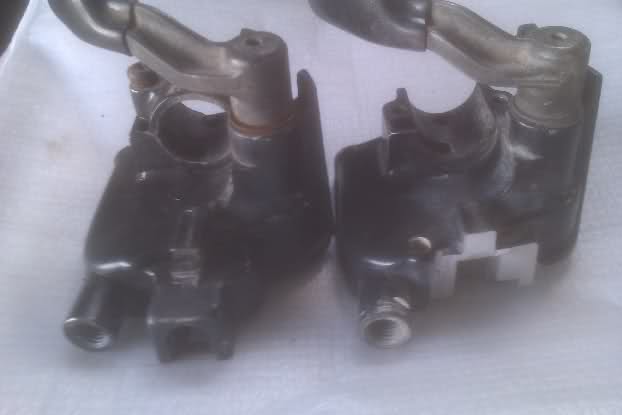

this isn't the first time i've done this, i also did this on the black blasty to allow room for the grip, throttle, hydro brake clamp and bar mounted hand gaurds on a set of 7/8" pro tapers, so this extra large throttle "tors switch" area is a problem on those 7/8" bars to when trying to use certain handgaurds

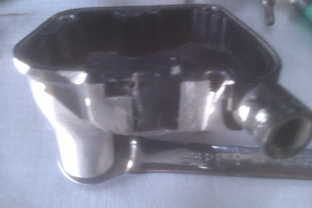

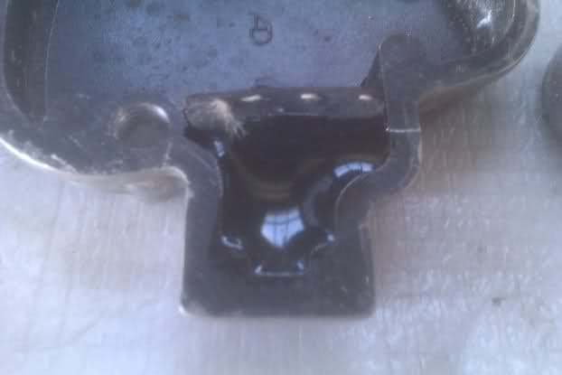

i cut off the "tors switch" area of the throttle housing to give me more room..............
i glued pieces of rubber hose in place to reseal the thottle housing,
using my favorite glue "Goop" of course
but also had to do considerable grinding to the lever rod area for brake lever interference....
i didn't cut the lid, as it cleared, but still needed to be sealed off.
small pice of rubber hose, then filled the void with "Goop"
the gasket isn't gonna work for that cut out area, but some rtv will.....

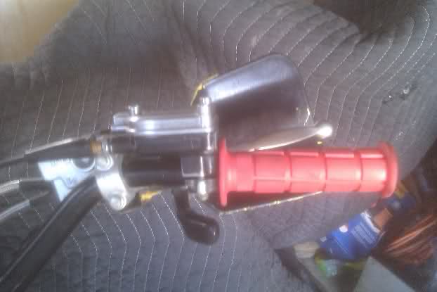

end result is a little better, notice the lever isn't sticking up at that ridiculous angle anymore as in the first pic...............
the new trail tech "X" bars extra 1/2" will help more,
