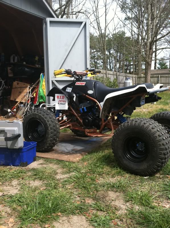

00 Blaster - +4 Swinger - 36mm Carb - PP Exhaust
Havent got there yet! I wanna get the motor running before i do anything else.. cause whats the sense of a quad without a motor! Im def gonna put lights on her, Prolly some walmart circle lights.. Brake light etc.

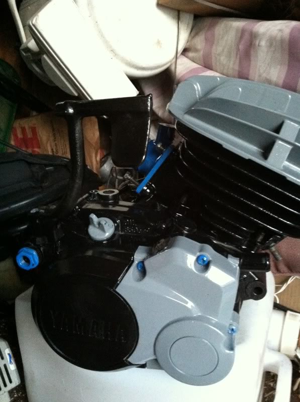

piston going in tommorrow

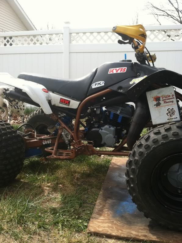

are those my gsxr brakes on that blasty ???
i see my master mount
and why did you connect them to an 03+ pedal ?
i've never built a set of those with anything but an 88-02 pedal/peg
i can see the angle of the rod going into the master is all wrong, it must go into it perfectly straight for best operation
looks like the hole in the pedal extension could move forward some ???
pull the pin from the clevis and let it slide forward to it's naturally straight position, mark and re-drill a new hole ???
