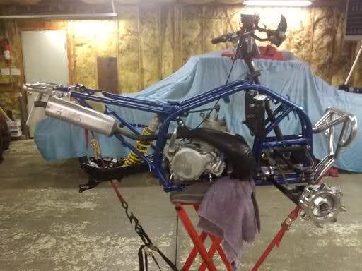

well, more updates! got the hubs painted and put back together with new bearing and seals

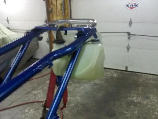

got the old oil tank mounted, going to use it as the over flow for the radiator

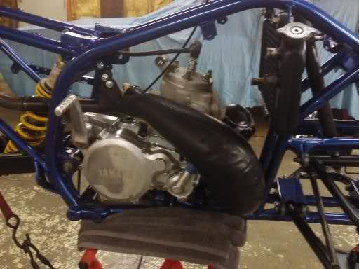

got the pipe, silincer, and radiator all in. the pipe is just sitting in there for now, waiting for a seal and new springs.
the pipe mount
the coil mounted

what are you doing for suspension setup? and i assume this is ice oval?
this could be the fastest yz swap ever!!!!!!
lol real fast! been saving these pics up just didnt post them up. we started around mid october but just started posting. as far as suspension goes we just use stock blasty shocks with front and rear lowering kit so it sits lower and the quad works real good for the ice and yes it is a oval.

Quote from the owner of another well known hybrid owner ... "Get rid of that tank" ... LOL ...
You'll see right away if it's pushing out any water. Won't be much if any in cold weather.
